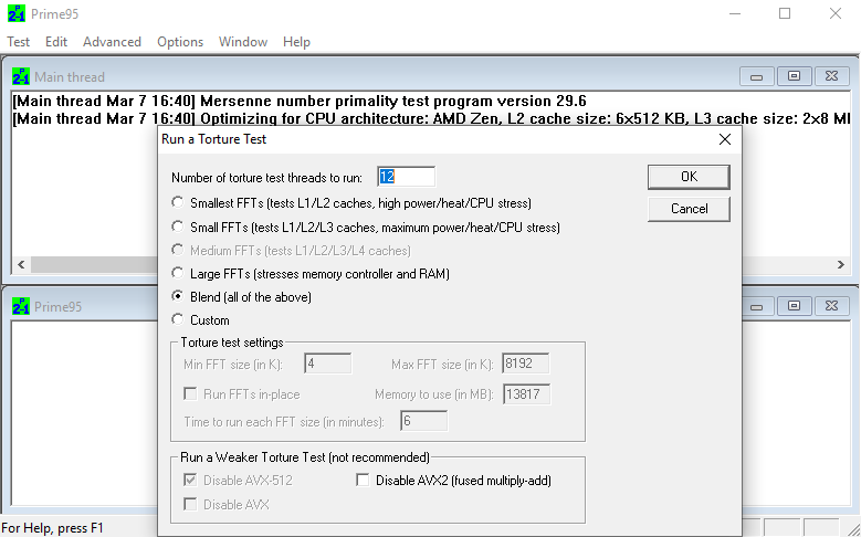

All versions after 26.6 have AVX enabled by default. So, if you're running the latest version, all you have to do - Run a Torture Test, but at the bottom, there are checkboxes next to the AVX options:
Although it says, 'not recommended', you really should. It doesn't affect AMD's Ryzen cpus, since they don't discriminate between SSE and AVX: they'll run the same frequency regardless.

Seems redundant to run weaker test on new build. Numbers look a little better. Up to 80C, but that stillseems high. Everyone says how easy it is to overclock this to 5GHz, but it will surely overheat.

Perhaps, but AVX instructions aren't widely used at the moment. At the very least, I'd suggest setting an offset of 2 or 3 in the bios.
While AVX is faster than the standard SSE instructions at the same frequencies, it does so with higher power and voltage draw, and higher heat output.

Games don't use much (if any) AVX technology, that's a set of more specialized instructions used mainly by game developers, CC etc. It's not a weaker test to run without it, it's a more realistic test, as AVX will drive a cpu upto @ 130% ish output in thermal watts, not good on a 9900k that can already hit 250w ish. For a more accurate test of 100% cpu load in a gaming environment, use the small fft torture test and disable all 3 AVX.

Was already running prime with AVX disabled. I ran benchmark until test ended. That was the only option free edition Heaven with a score of 4548, which I am sure is prob irrelevant.
