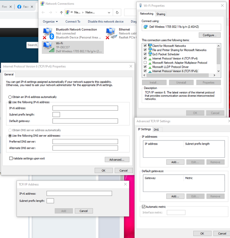

Sorry. I found the thread below and am trying to follow along with the instructions on how to setup 2 ip address on a windows 10 machine here:
https://forums.tomshardware.com/faq/can-my-computer-have-more-than-one-ip-address.1606720/
but that seems to be a little outdated. Anyways I am up to this screen where I have to add the 2nd ip address [I think].
Please see attached screenshot of my steps taken. If I need to enter a somewhat similar ip address to my actual ip address in the IPV6 address field then can anyone tell me what do I enter in the "Subnet Prefix Length" box under it please? Thanks.
https://i.postimg.cc/9XZhnhPW/ip.png
