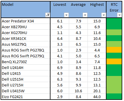

It really doesn't matter what the advertised response times are are exaggerated by the manufacturer's habit or redefining what "response time is" and they rarely pan out when tested. For example let's look at the average response time of the selected 2415H ... it's actually 9.3 compared to the claimed 6.
If Image not displaying you can find it here
http://www.tftcentral.co.uk/images/asus_rog_swift_pg279q/response_12.png
On short look at the real response times, not the fake one manufacturers place in their advertising.
I'd be more concerned about lag which is much higher (13.7) which would be a concern for many competitive gamers ... 16ms at 60 hz is generally considered the threshold for the gaming community tho of course serious F{S fold want to stay as far below that as they can.
