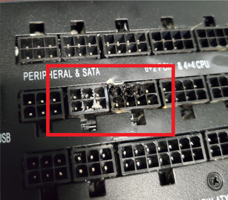

Here is a 3090 with a PSU cable mod.
Mining ftw. Two 3080's.
Reason this happens.
A single 8-pin connector’s maximum current rating is up to, and sometimes more than 24A (288W at 12V). However, the connection at the GPU is only rated for 75W (6-pin) and 150W (8-pin) total for graphics card power. Therefore, it is not recommended to use a single cable that splits into two 8-pin PCIe on higher end graphics cards.
Why correctly powering your GPU is important in mining.
Information on the 12-pin connector. The new ATX 3.0 and PCIe 5.0 spec provides a single 12-pin cable from the power supply to the GPU. PCI-SIG blamed everyone else for any problems.

Not a card issue, no need to recall any cards or refund anyone. Cablemod uses <Mod Edit> wires that aren't actual copper but a 60/40 alloy (transformer grade), and the connectors they use are basic PVC instead of a heat-resistant polymer, aka the cheapest you can get in China.
That wouldn't be a problem by itself if the cables were reasonably priced, but this isn't the case, they sell this crap at like $200 when their production costs must be around $10. You can get exactly the same stuff in Aliexpress for 15 or 20 bucks but it comes packed in bubble wrap instead of a nice little bag with a cablemod logo.
Now the reason the connector melts or catches fire ISN'T the card or power supply but the wire, you could say current "bottlenecks" (ugh I hate that term) at the connectors since the wire can't handle all of it, current creates heat and warms the wire, wire gets too hot and melts at the weakest part which is usually the crimped terminal and that in turns melts the plastic connector.
If you work with AC appliances and purposedly use the wrong wire gauge for say a heater that uses a lot of power then the same would happen, the plug and socket would melt due to the heat caused by the current trying to flow through a thin wire.
The connector is also somewhat... subpar for the amount of current these cards handle, pins are just too small and the mating force too low, in layman terms "it wiggles", and that's bad as it creates arcing in the contacts, at one point the contacts burn or deform and offer more resistance to the current = more heat = bad.

8-pin connector melt all the time, its comon in mining. Note this cable is melted at both ends.
Example and here. Here is it happening in 2016 to a gamer. Melted pcie from PSU to GPU Burned PCI-E connectors to GPU PSU cable melted, bad PSU or bad cable? The whole cable melted into the carpet. PePew
With the new power connector nVidia did get taken to court.
8-pin connectors melting is common.
Here miners burning other cables.

Miners burn/melt every type of cable they use. Its really an all come be burned/melted type of thing.
View: https://youtu.be/qFraCHaOXEs
