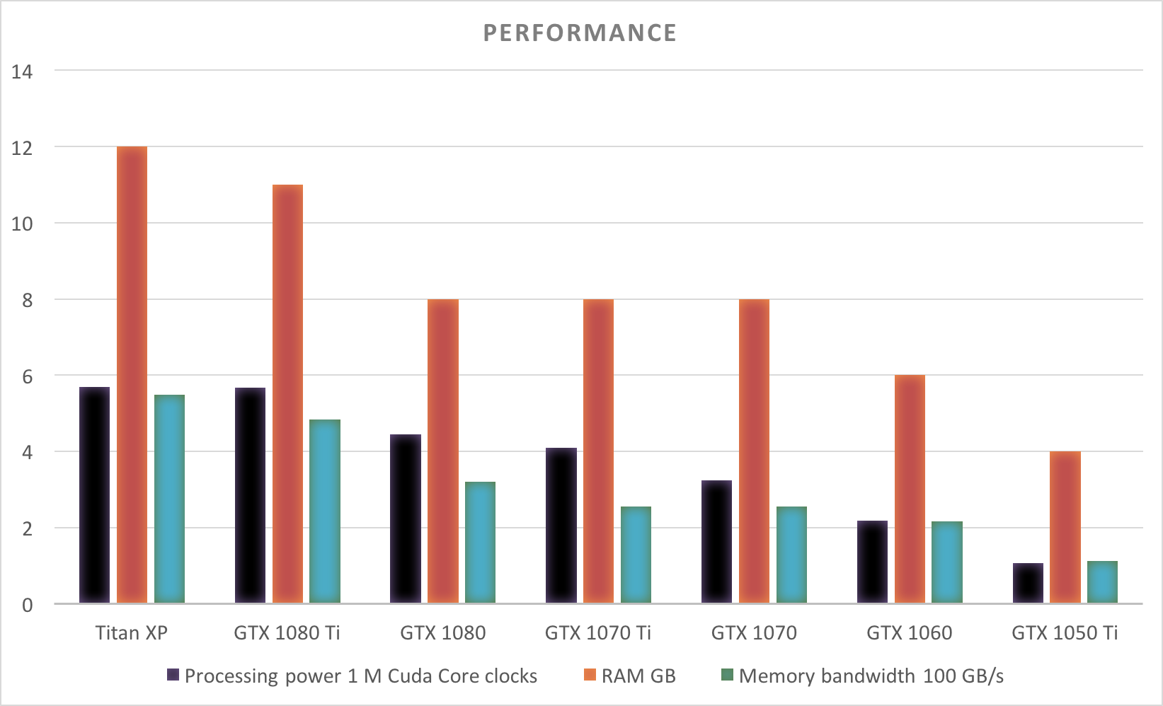

Any reason not going 1080ti?
This shows me the scaling of # of gpus is sublinear, it looks roughly 11 for ti, 8 for non-ti, so 3 1080ti may be faster than 4 1080.
