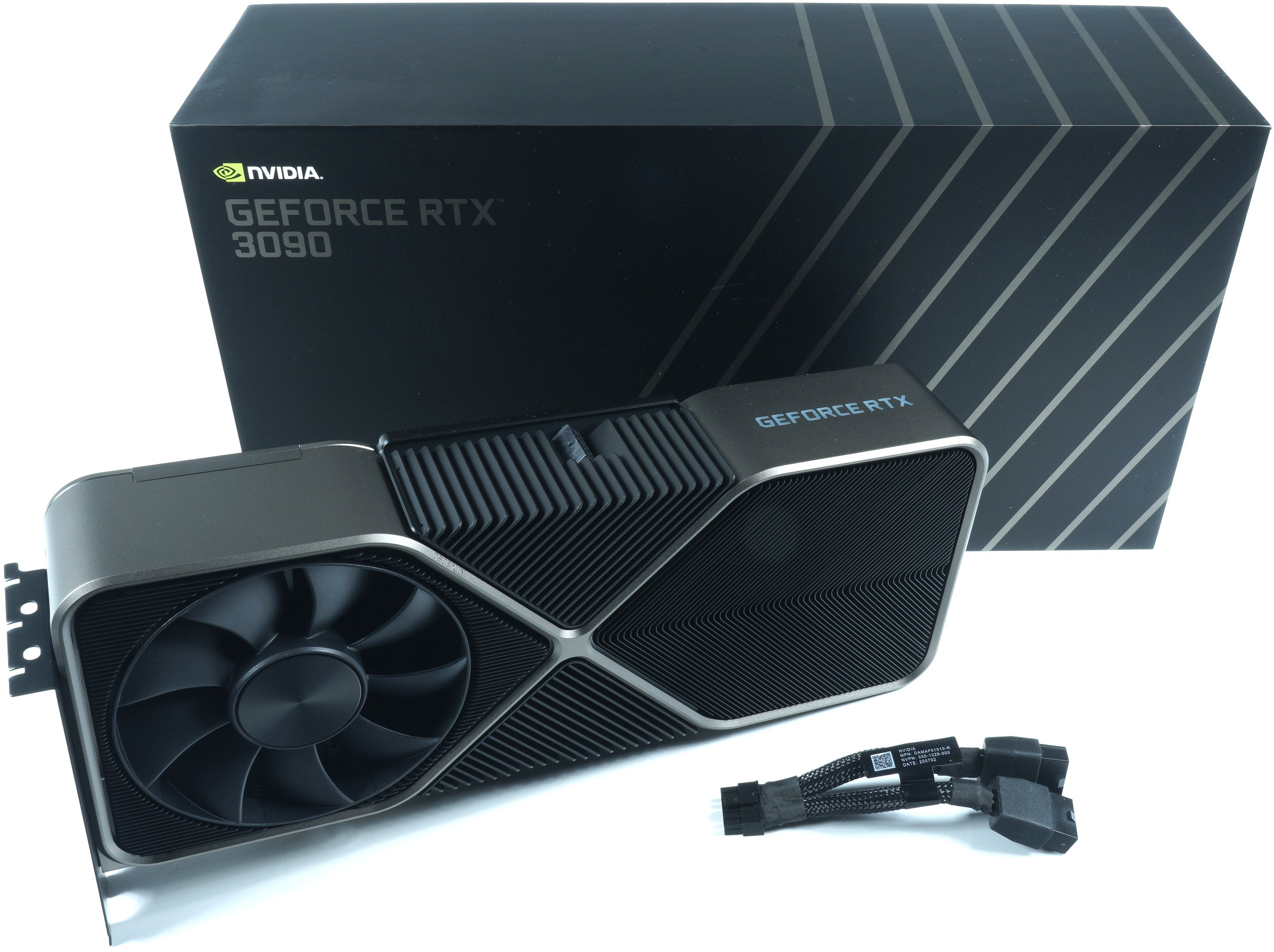

Although I wanted to build a new pc this year I ended up buying a pre-built power spec pc from micro center with an AMD 5900x and RTX 3070. Currently I find the RTX 3070 limiting in what I am doing (deep learning). I want to get a 3090. The power spec pc came with a 750W power spec branded PSU. Will this be enough for the 3090 and my processor? I guess if its not I have an 5 years old 850W PSU in my old pc which is kind of overkill for a GTX 1080 (I used to have a titian for compute in that pc as well.) so I could just do a PSU swap. Or not sure if I want to reuse a PSU that's now a bit over 5 years so I could just buy a new one.

Most 3090 cards will need two 8 pin aux power connectors.
A quality 750w psu can likely do the job.
If you buy a factory overclocked card with 3 8 pin connectors, that could add up to 150w to your needs.
