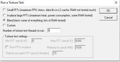

26.6 Default Test Settings
Notice the shaded out area - Memory to use (in MB)=1600, and Time to run each FFT size (in minutes)=15

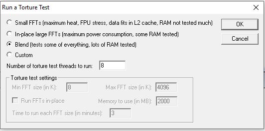

29.4 Build 8 Default Test Settings
Notice the shaded out area - Memory to use (in MB)=2000, and Time to run each FFT size (in minutes)=3
By choosing CUSTOM and reversing each version with the others default settings, the temps are adversely affected.
