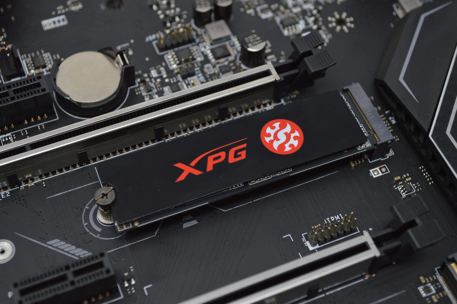

It should be the same/similar hardware just built in a different manufacturing facility. It could just be a stock photo. Can't know unless you have one in your hands.Was just about to buy a XPG SX8200 hundred in 2TB based on the great review in Toms and the good pricing but am concerned about a change in production from "Made in Taiwan" to "Made in China".
The picture in the review and shows a SSD "Made in Taiwan" but when I went to Adata's website the product photo for the 2TB (and all the others) shows photos that say "Made in China".
Is Tom's getting review hardware that is different than the production model or have they made other changes to the product with the change in production location ?
I am buying as few "Made in China" products as I can (Not always easy). The XPG no longer makes the cut for me even if the performance and materials are the same as reviewed.
There is no reduction in performance nor any bait and switch. Adata packages the NAND themselves but they may not always have enough supply. Adata is a very large company so it has variuos suppliers to help fulfil demand. While the NAND packages, in that case, may be UNIC, its most likely IMFT 256Gb 64L TLC as it should be for the product. The performance numbers look fine to me. Performance figures vary depending on the benchmark, the system used, and configuration settings. That user has an X570 motherboard and is probably even using the device in the PCH connected M.2 slot, which adds latency = reduced throughput.Some others have noticed a reduction in performance.

That has to do with the SLC caching policies in the firmware. When the devices SLC cache is full, the Silicon Motion SM2262EN controller will only recover 4-6GB worth of cache within a few seconds after the workload ends and it is left to idle.Hi everybody,
