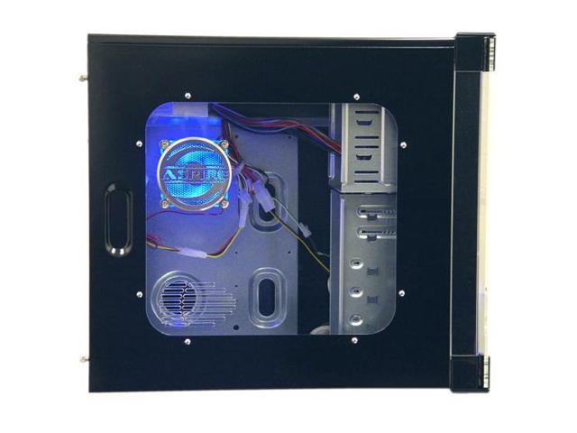

ADVISE FOR CASE MOD PLZ HELP
Hello rom Greece...
I don't think u could ever get maximum airflow with this Case... Mostly because the front side has no ( visible from the photos ) air holes...
In order to achieve maximun airflow u need an air input at the front low side of the case... preferable with a 12" silende fan...
Then u must have an air output in the high back side... which i thing u get with this case...
If the case does have front air holes just install a 12" fan and u should be just fine...
Another critical aspect is that the space inside the case must be as tidy as it can get. Gather cables and whatever u got inside and push them to get out of the way of the airflow...
A good hint is to buy round IDE cables...
Hope i helded...
I noticed in this view, there are 2 fan mounts for 80mm or 60mm fans so that may help out. (in the front, to cool hdd?)
Also there are some vent holes in the side panel here and maybe you can carefully put a fan there as well to help cool the gpu & other cards, if you don't mind some light modding.
The first thing I would do is optimize intake/exhaust. Make sure that you are using some fans to bring air in and are moving at least that much air out with your exhaust fans. As previously recommended, you should ensure that your cables/wires inside the case are not restricting airflow.
If you look closely at the front, then you can see the air holes to allow 2 fans to bring in air. A major restrictor to that airflow is the closing glass/plastic door - try leaving this door open.
One thing I did notice about the fan intake/exhaust areas is that the holes are rather small - at least on the back panel. The small holes will restrict airflow AND increase noise. You can use a dremel to widen the holes or cut them out and replace them with wire fan grills.
Are you experiencing high temps inside the case? What makes you think that you don't have good airflow right now?
thanks, but i'm ahead of u already, as i said i have all the fan spots filled (2X80mm front, 120mm rear, 80mm side), and i already slightly modded the case so that the door is no longer even attached to the case. at all. I already noticed the fan holes being smaller than that of the hexagonal ones on my old case and plan to us a fan guard as u mentioned instead.
, but since this system is not yet built, i was asking because i wanted the most efficient, quiet airflow possible without severely altering the aesthetics of the case (ex. cut in fan hole on top, side window, cut out better air holes in front)
i hope geostuff was talkin about 120mm fans and not 12 inch fans cuz 12 inches is BIG.
I don't think that i have bad airflow nor do i have temp problems. PLEASE give me advice on recommended fans, heatsinks, HSF, and other cooling methods. thanks.
Since the front panel seems to be mesh, you can always set up a fan to pull in cool air from the front. I have a Raidmax Ninja which has a mount for either 80 or 120, but I would have put one up front with zip ties if it didn't. I also used my side spot for cold air in since it will be over the cpu cooler. I went with coolermaster silent 3 pin fans. I don't have my working parts yet, but I did test my air flow with a spare PSU, and my exhaust fan in the rear seems to be blowing more volume than it does by itself. Once I get all my innards,
I might upgrade the front fan to a Scythe S-flex.
Good luck.
