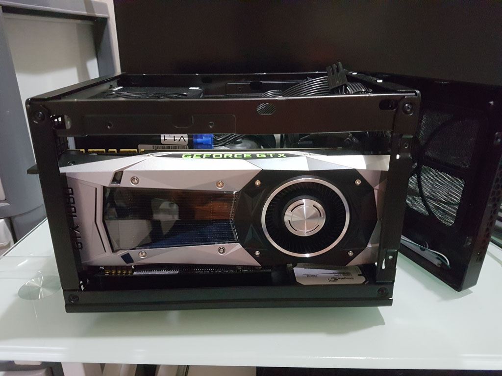

yes the gtx 1060 is the best gpu you can safely use with your system
however you need to get the blower version, as the cooling is pretty terrible inside that case
like this one:
