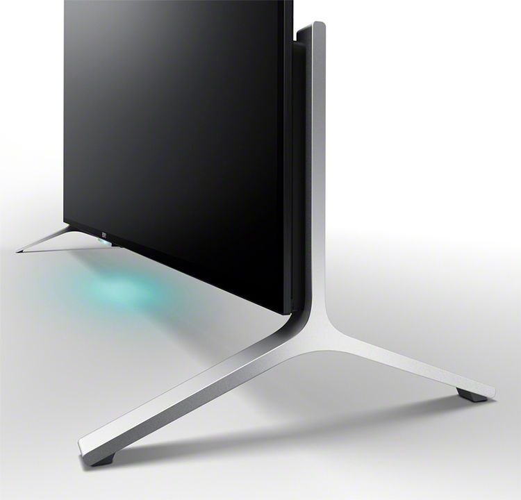

1- This will be unbalanced ... try pushing it and see the balance , I have the feeling the center of mass is back..
better make the legs on the side ...
something like this maybe
