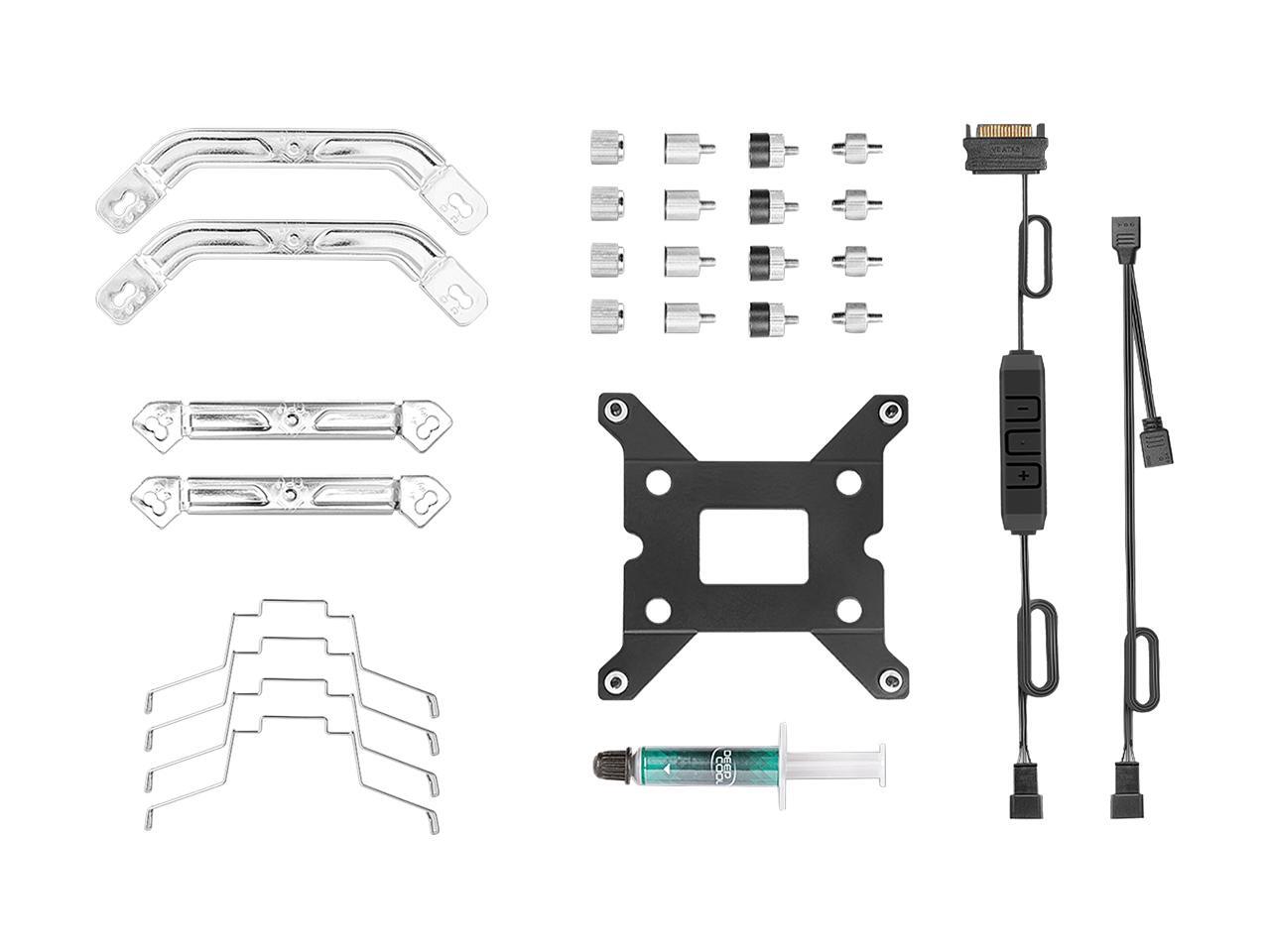

I then went to install my new CPU cooler, a Deepcool AS500
Imagine my shock when it wouldn't fit. Not spacewise, plenty of space. But it won't attach to the board, does not fit my AM4+ socket type. it has two pegs when what i need is a clip with a lever.
There simply are no holes on my motherboard for those pegs. The board is...

You remove the stock mounting bracket when you install most aftermarket AM4 coolers and use the mounting hardware shipped with the cooler itself.
There was no way to possibly do this, no additional hardware shipped with it.
It had two huge pegs and there are simply no holes on the motherboard for them to go into

It seems you don't have the additional hardware that should have shipped with the cooler you have. See here:
https://global.deepcool.com/products/Cooling/cpuaircoolers/AS500-CPU-Cooler/2021/124.shtml
But there's also AM4+, isnt that different?
You are right, i dont have that stuff, the box contains only a single item, the cooler itself, zero acessories of any kind, i jut double checked :(

Then you need to contact the store you got it from, or Deepcool. From what you're saying, the mounting hardware was completely missing:

Only smaller coolers will attach with the clip system big air all need special mounting hardware because of their weight.
