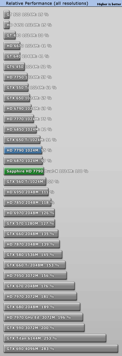

No offense, but the benchmark and comment didn't make sense when I actually read them. I assume that stickmansam meant to say that the 7790 is 2.5 times faster than a single 6670 and that was the mistake which would most certainly prove the point about the 7790 being faster, but it still invalidates what was said about CFX.

makes perfect sense....not sure what your missing. it shows 6670 is not up to par with 7790 and he states the scaling issues that the graph doesn't cover. i prefer sli if going multi-gpu. less buggy and usually better scaling.
[citation] The 7790 is 2.5x faster than a single 7790 [/citation]
[citation] CFX [/citation]
[citation] CFX only scales from 50-80%b [/citation]
[citation] CFX only scales from 50-80% so 150-180%[/citation]
No, it didn't make sense. The first citation states that the 7790 is faster than a single 7790, an obvious typo, but still wrong nonetheless. The second is wrong because CFX isn't in use here, that would be CF or more accurately, because a Trinity APU is in use, it's just called Dual Graphics. The thirs part specifically states that CFX only scales from 50-80%. There are several things wrong with that, but I'll just tackle the main issue in that CF nor CFX nor Dual Graphics nor any other such form of multi-GPU technology from Ati and AMD only scales within that range.
The last is wrong in my opinion rather than fact in that it gives the implication on the graph that we should look in the 150% to 180% faster than the base of 100% despite the fact that we should be looking for something 150% to 180% faster than the 6670 itself. Also worth mentioning is that the 6670 in that graph is a GDDR5 version despite the fact that we only need to care about DDR3 versions for Dual-graphics because the GDDR5 version is less suited for it.
Another thing that I find to be worth mentioning is that none of this was pointed out, so OP may have assumed that the data in that graph was relevant for comparing the performance that OP would get out of a Dual Graphics solution with the A10-5800K and a Radeon 6670. That's taking shortcuts in giving advice and I really try to avoid someone not getting the fullest idea that I can give, within reason, when I'm giving advice.
None of that is meant to be offensive to anyone and I apologize if it does offend anyone. Even if it's selfish of me, I wasn't going to just deal with being told something that is nonsensical does make sense and I'm deficient in some way for not thinking so. I may be over-thinking it at this point, but I'm still technically correct.
One last set of points to make: SLI does not usually scale better than Crossfire, at least not with modern cards (modern being VLIW4 or GCN GPU-based cards from AMD and Fermi or Kepler cards from Nvidia, especially with Fermi) and even more important is that both this and especially how buggy each is depends on driver version, game, and more, so no wide generalization is important nor even likely to matter.
I don't have a problem with that. I only have a problem with what you said in that because you said it only scales 50-80% rather than it usually scales 50-80% or something with similar meaning, especially since you didn't specify something like Crossfire with those two GPUs and current drivers or such because Crossfire's scaling tendencies can vary greatly between different GPUs, different GPU architecture, different drivers, and that's just a start without even going into games (which can also be impacted in scaling by settings and more).
