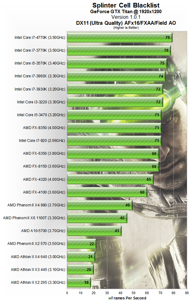

Here are some examples of why you should not get an AMD APU for a gaming rig if you can afford to buy a more powerful CPU. The benchmarks uses the prior generation Trinity APU (A10-5700) vs. the current generation Richland APU. The only difference between the two is that Richland officially supports DDR3-2133 RAM. Reviews have shown there is very little performance difference between the APUs.
http://www.techspot.com/review/706-splinter-cell-blacklist-benchmarks/page5.html
http://www.techspot.com/review/689-company-of-heroes-2-performance/page4.html
http://www.techspot.com/review/670-metro-last-light-performance/page6.html
http://www.techspot.com/review/648-simcity-performance/page4.html
http://www.techspot.com/review/642-crysis-3-performance/page6.html
http://www.techspot.com/review/615-far-cry-3-performance/page6.html
http://www.techspot.com/review/608-hitman-absolution-performance-benchmarks/page6.html
