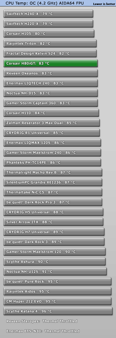

My FX9590/CHVF-Z is running at 48 deg C at full load with Corsair H80iGtx in a Storm Enforcer with maximum ventilation I haven't overclocked it. I am extremely pleased and satisfied with my purchase. I was worried also, due to scary stories out there but I am very pleased and have put the 8370 up for sale. I could run ANY game at ultra with my 8370, so 9590 more than enough for gaming.
No offense, but I don't believe you. Almost nothing can cool the stock 9590 under full load at 48c, certainly not the H80i GT.
Here is a H80i GT benchmark with i7 4790k OC 4.6 ghz w/ 1.3v under full load. That i7 at 1.3v runs much cooler than 9590 at stock, and it is still at 73c. Therefore, the H80i, and most other single fan AIO cooler, won't be able to sufficiently cool the 9590 at stock.
index.php
And this,
Reference:
https://www.techpowerup.com/reviews/Corsair/H80iGT/6.html
http://www.guru3d.com/articles_pages/corsair_h80i_gt_review,11.html
XpJAY
Jun 12, 2011
88
18,660
What? Lol!! Many Intel chips known to run ridiculously hot when overclocked pass a certain point no matter how you cool them, unlike FX series. It's made by a different manufacturer. Why would you even show these graphs? And if you actually looked at your graphs you would have noticed in 1 test, the dual fan H80iGT 120 mm cooler outperformed the 280 mm H110, and in both tests beats 240mm Nepton 240M. "Lower is better"
Also, AMD specifically listed the dual fan H80i (non GT) as suitable for the FX9590.
Yes they both have 2 fans. Check your facts.
