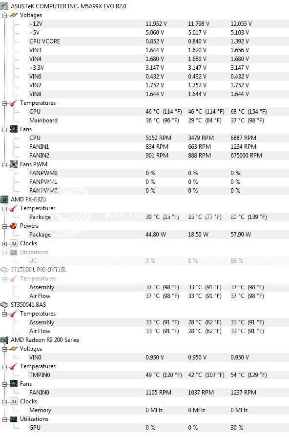

Have an fx8320, asus M5199X mobo. The CPU idles at 40, runs at 50 for videos and goes to 60+ for light performance games (like card games). Have cleaned it out of dust, replaced the thermal paste (while checking the heatsink/fan were all inplace correctly)... the fans all seem to be functioning..
I guess its worth pointing out it didn't always run this hot and is a few years old... any thoughts?
https://i403.photobucket.com/albums/pp115/RTSD/PC Monitor Stats.jpg

1) using stock fan is not the best option but you limited with options running that board.......
2) using stock thermal paste? you will see a drop by using quality thermal paste over stock.......
3) how much thermal paste did you use when applied? only need pee sized amount.......
4) is the processor overclocked at all? might have too high vcore, or too high frequency.....
5) any case fans beside exhaust ( normally one behind vram and input and exhaust is fine....
6)your CPU fan is running very high I noticed.......
7) if worried about temps, get hyper evo 212, and pea sized amount of thermal paste
