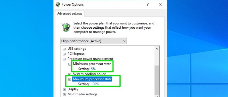

You should be able to adjust the USB sleep setting independent of the overall power plan setting in Windows too. I believe you go to "Control Panel > Power Options > Change Plan Settings > Change Advanced Power Settings" where you can find the "USB Settings" in Windows 10.
On a laptop it make sense to have this activated as it saves energy somewhat(?) but on a stationary PC disable it.
Also make sure You use Amd Ryzen power plan - balanced is good enough since you also can adjust energy savings for the processor Min and Max. For ex. Min 5% Max 100%.
And with Amd Ryzen Balanced power plan it should be less VID Voltage to the CPU under idle (compared to High performance power plan) and therefore less stress on the CPU.
sample pictures. Use balanced instead of high performmance power plan - my tip. It really makes no diffrense regarding fps in games that I have seen, but better for the cpu and motherboard in a long term.

AMD Ryzen Balanced power plan is not required on any Ryzen 5000-series.
Just go with Microsoft Windows Power plan but still make the changes suggested.
