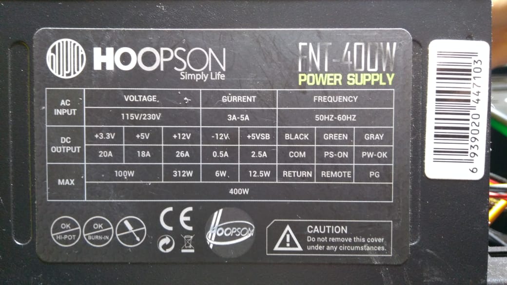

The RX550 is not a power-hungry card.
That said, while I can't speak to the 550w version, the Hoopson FNT-400W PSU has this on the label side:
152c36c8-04ea-4b72-bc71-896b766779b8-jpg.118055
If the 550W is similar, it probably produces only about 400-450W on the 12V rail. NORMALLY, that should be enough.
BUT... for the 400.
Only 312W total available on the 12V rail for a PSU advertised as 400W.
No 80 Plus rating at all.
This suggests to me either an ancient PSU, or at least one based off an ancient design, and one of low quality and low efficiency.
Are you in Brazil? My searching suggests that the Hoopson is generally available there.
While it may not solve your problem...
BUT... for the 400.
While it may not solve your problem, just as a safety measure, I'd recommend getting a higher quality PSU. Note that, while 80 Plus Bronze, Gold, etc., represent efficiency, they don't always correspond to higher quality.
The first two links in my signature offer recommendations. But, if my guess is right about your location, not everything mentioned in those links may be available in your region.

Yes I live in Brazil, my font I'm using is this
https://ibb.co/tJPT48F
But if you think the problem is the source, why only happen when I open editing programs like after effects or sony vegas?

I can't be certain - although I imagine if they put a sudden high load on the system, then that also puts a sudden high load on the PSU.
The PSU is a safety device. It should be able to provide clean, stable power. If something should go wrong, it should also protect your equipment.
Good PSUs, if they die, will not take other components out with them. Bad PSUs can also damage other components, or possibly catch fire.
Still, can I be 100% sure that this is the problem? No. However, I strongly suspect that it is at least contributing to the problem.

ok, i have to buy a good quality font, to see that the problem is solved.
