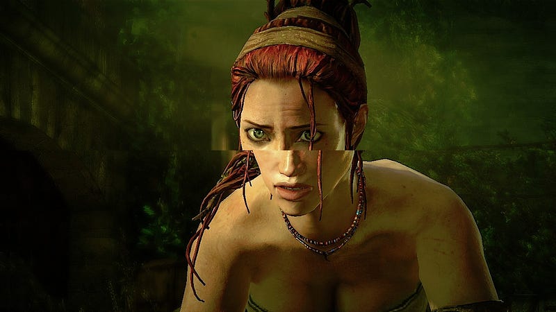

Hold on a second screen tearing is a normal occurrence. First off to lower screen tearing you should try V-sync. The second thing would be a higher frequency monitor.
Just so we are sure we are on the same page this is screen tearing:
Is that what you see (but worse)?
Yeah it's similar to this. What it's doing is the graphics are tearing in triangular shapes, in various sizes all around the screen, and does so randomly. For Overwatch, it does it a lot on the main menu screen when the characters stand idle, and in game it happens if I'm moving a lot, or raise the graphics settings.
My monitor is a 1600x900 monitor. Would that be causing the issue? I've tried lowering the in game settings to 1280x720, in borderless, full screen, and windowed formats, and non of those things made it any better.
I actually have dual monitors. My main monitor is an HP 2009 Series Wide LCD Monitor, and the secondary (that used to be my main monitor and still had difficulties) is an HP W2071d LED Backlit Monitor. Both run at 60 hz.
They are both also 1600x900 monitors if that information helps at all.
Ok so definitely decent monitors, have you tried turning on V-sync?
Full screen will give you the least tearing, the resolution shouldn't cause you issues (the native resolution of the monitor is preferred).
TBH it sounds like normal screen tearing to me however if there is any way you can get a screenshot somehow of the triangular tearing you are seeing I would like to review that.

I was able to catch one of a million tears that happen every minute. Seriously though, it tears constantly so it took me maybe 2 minutes to actually catch the tearing. I have the game at all Medium settings, and Vsync is on.
Okay i thought i connected the image correctly, but apparently i did not. Here is the url to the imgur screenshot i got.
http://imgur.com/knHITmc
The tear happens on the characters right arm in this instance, but the tears seem to be pretty random overall, and for this character in particular, they occur all around his body and are mostly vertical tears. On the main screen though, I have tears where they are sometimes diagonal, and span from near the character models, to the background scenery, and even the menu options.
Oh thats actually not screen tearing.
Thats actually called mesh ripping, and it can indicate a number of problems. Now of course we have cleared out the drivers as an issue. Are you overclocking it at all? Have you checked the temperatures when running it?
If you are not overclocking and the temps are not excessive, then your GPU is straight up going bad.
