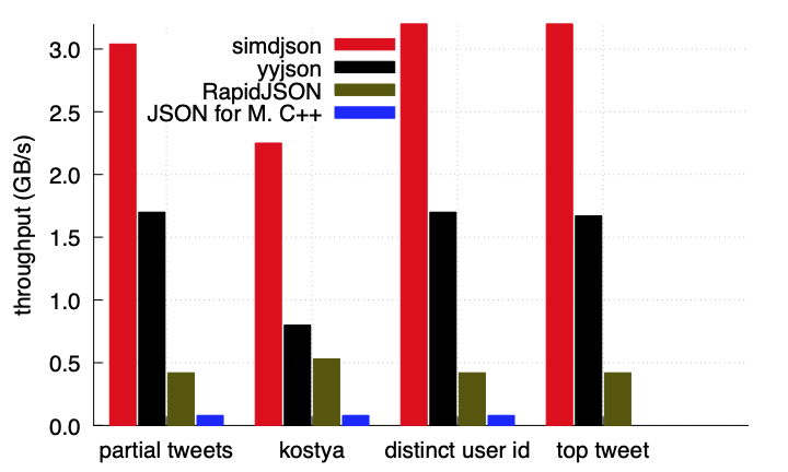

I don't entirely disagree, but there have been some interesting applications of it to accelerate string processing.
https://github.com/simdjson/simdjson?tab=readme-ov-file#performance-results
However, that data appears to be just for AVX2 (uploaded March 2021; its filename suggests it was measured on Zen 2 EPYC). When optimizing with AVX-512, they managed to find another 60% performance improvement!
Something else about it that a lot of people might not know is that it's not restricted to processing 512-bit vectors. The same instructions will also operate on 128-bit and 256-bit operands. Furthermore, there are aspects of it which facilitate vectorization, such a dedicated set of mask registers that perform per-lane predication. It also doubles the number of software-visible vector registers. Along with a few other details, these improvements make it a superior alternative to all of the prior vector ISA extensions, such as the SSE family and AVX/AVX2.
