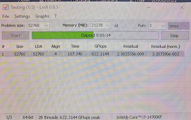

"I will be more understandable this time. I have written the configuration of the computer. The program I use is LinX-0.6.5 for Windows. Additionally, I check the temperature using HWMonitor Pro 1.53 x64. As I mentioned before, the computer is built from scratch. The CPU cooling involves a top-mounted cooler and air intake from the front through three fans, while the air is pushed out at the back by one 12-inch fan. I am attaching a screenshot of the temperature. What bothers me is the absence of a hot air flow from the CPU radiator. As I mentioned earlier, in my previous computer, when I ran a benchmark, the CPU radiator fan would kick in after about three minutes, running loudly, and there was a noticeable hot air flow. However, here, I don't observe any hot air flow, and it worries me. If I see that the processor is at 100 degrees but there's no hot air flow from the radiator, I assume it's not cooling properly, especially if it's reaching 100 degrees within 3 minutes. I'm attaching screenshots."
5 minutes of benchmark at Antec p20c
NO hot airflow from radiator. Slightly warm
same time same benchmark at OMEN 30L 10700K
And massive hot airflow from CPU radiator.
View: https://youtube.com/shorts/MyFmhJ6t7yE?feature=share
- OMEN SOUND OF RADIATOR
View: https://youtube.com/shorts/mvtx8Ku8CVA?feature=share
Antec symphony 360
I hope I explained the issue better this time
Mmmk, I got a much better idea now - it doesn't sound like anything's wrong with the cooler at all, but you didn't really know what was going on. Your original post read like both PCs were running a 14700K too.
So LinX appears to be one of those extreme benchmarks that puts too high of a load to be practical.
If you're going to be running benchmarks/stress tests like that, you should be experimenting with your own custom settings, and not the motherboard defaults.
"What bothers me is the absence of a hot air flow from the CPU radiator."
You can't trust what your hand feels. That doesn't mean the cooler isn't working - see below.
The 10700K is easier to cool due to being built on a larger lithography. The hot zones/spots on it are larger, and thus easier to transfer the thermal energy from the die up to the cpu cooler; the thermal density is higher.
All this lithography/die shrinking has brought us to a hard wall in regards to moving the heat from these tiny zones effectively.
I can tell from your screenshots that the Omen's mobo isn't running an overclock(and following the Intel spec), but the other board is, by looking at the Powers section.
The 10700K has dropped down to the 125w PL1 state after the time limit for turbo boost(229w PL2) has expired, which is 56 seconds by default.
The 14700K, on the other hand, has exceeded its 253w PL2 and appears to have stayed up there the entire duration of the test.
What we then have is:
Scenario A(Omen)
Though this cpu is easier to cool than the other, it takes longer to hit 100C because it's running 125w for the remaining duration of the test, combined with the poor case airflow and small cooler.
Scenario B(DIYPC)
Hit 100C in a scant 3 minutes, even though there's a larger cooler than what's in the Omen, and the case should have better airflow.
Cpu has greater thermal density, is overclocked and never eased up on the power.
There's only so much cooling one can brute force on the higher fluid volume of an AIO, before the wall becomes the very silicon they are trying to cool, among other things.
I believe your results are as expected. If you tune the DIYPC's power limits and turbo duration to that of the Omen's, it should take longer to hit 100C - I'm not going to say it won't hit 100C, because of how extreme LinX apparently is.

This is the broadest and most accurate explanation I've ever received on a forum. Thank you so much! Indeed, Scenario A works at the standard frequency as if it was bought in the store. My assembled computer works the same way, but it was already overclocked out of the box. My CPU cooling system can handle TDP 250 watts, while the processor reaches TDP 273, and obviously, it can't cope. I adjusted the voltage in BIOS, reduced the power by 0.100, and that's it. The processor no longer exceeds 80 degrees, and the power doesn't go beyond 248 watts.
here some screen
Linx
done without errors and no OVERHEAT
And then i have turned aida stress test to make sure. 2 hours and no overheat.
I believe that undervolting is the best solution.
Here is the spec after the benchmark - maximum temp of the package is 85
I don't think I'll find a 360 cooling system that can handle a 300 TDP. So, by reducing the power, I've lost a bit of performance, but now the processor operates within a temperature range where it feels normal
