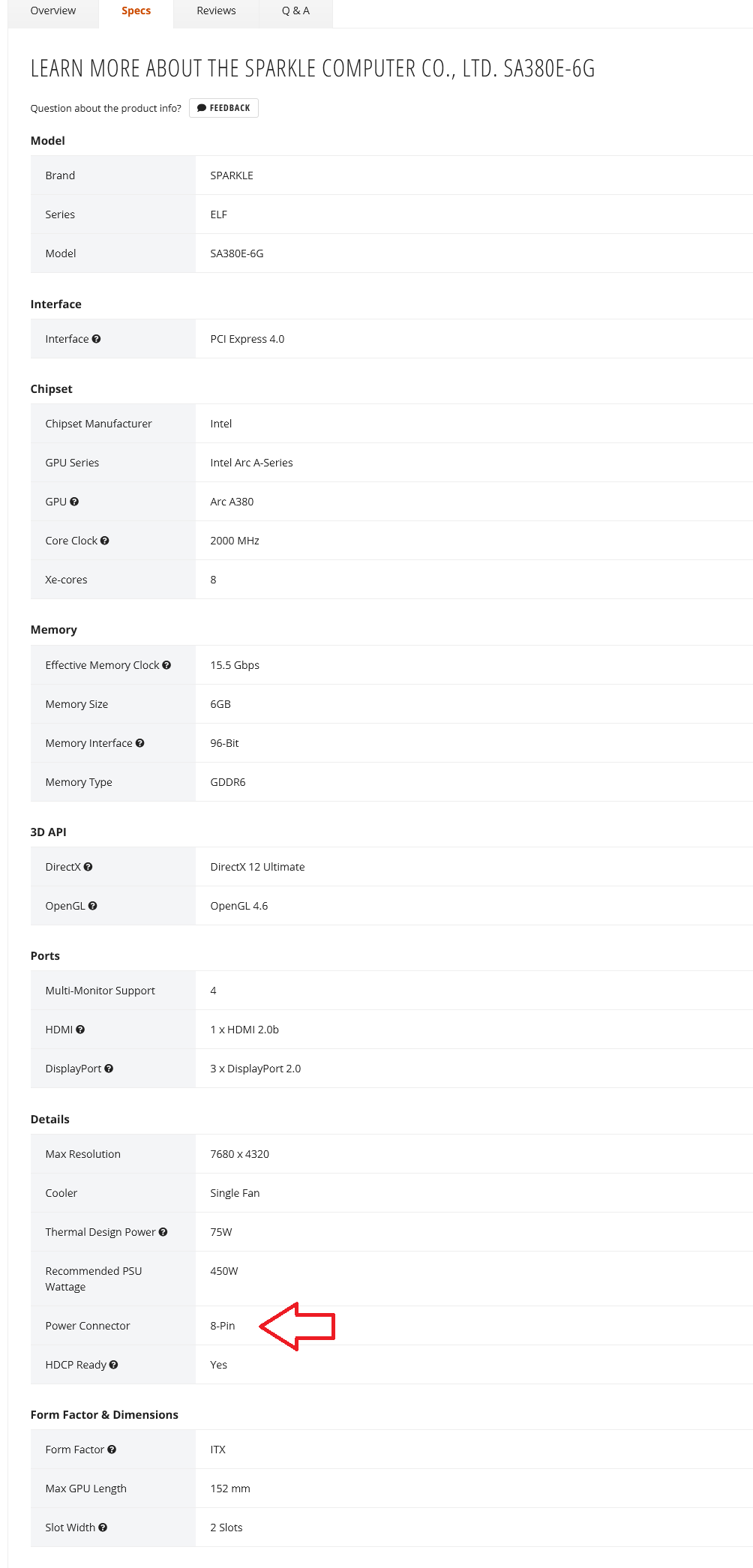

I want to believe you, but specs posted at Newegg indicate otherwise:
Did Newegg get it wrong?

That link literally says 1 x 8-pin connector.
Every other Arc 380 I've found online (with actual photos/reviews) has an 8 pin connector.
I'm not convinced about that Sparkle card at all. The images are all CAD renders. It would take more than a single anonymous review on Newegg to convince me.

On the same newegg page, the gpu got 1 customer review. Plz read that XD
Okay I see that. Wow confusing. I sent an email at the Sparkle website to clarify if there is an 8 pin connector or not and why did Newegg post specs that include it. I also asked why would a video card rated at 75W come with recommended PSU of 450W?
Info for the SPARKLE Arc A380 ELF is posted here https://www.techpowerup.com/gpu-specs/sparkle-arc-a380-elf.b11313
Note here they say suggested PSU is 250W, not 450W. And look just below that and you see again spec says 1 x 8-pin power connector required.
Incredible. All kinds of contradictory info on this.

They made a mistake, the Arc 380 ELF does not have any power connectors.
See a video here
Yes I see. The "runt of the litter" as he calls it in the video is definately the Sparkle A380 Elf. Vid also makes clear "requires no supplimentary power." Nice work. Now we know, unless there are also overclocked cards being sold ?
