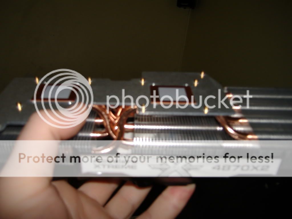

Notice the 8 heat pipes used to cool both gpu cores:

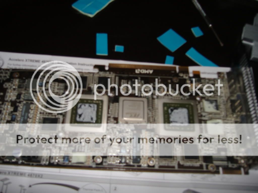

4870x2 with the stock cooler off.
Now the cooler is ready to go on, after the memory thermal pads and heatsinks for voltage regulators etc. are installed.

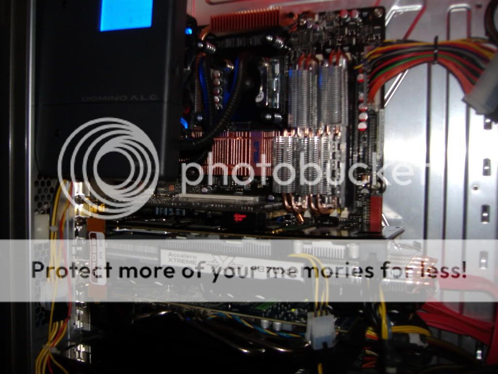

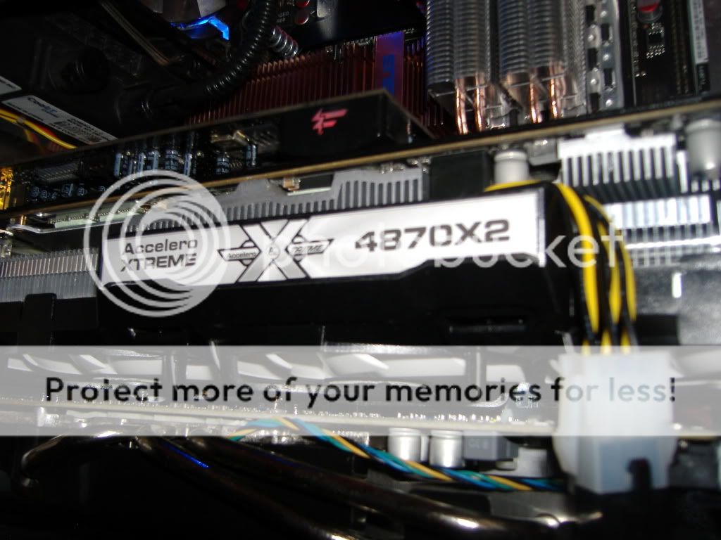

And it is mounted! Notice, this cooler is more than 2 slots thick, probably closer to 3, so alot of room is required. In fact, the bottom fans almost touch my 48701GB !
My rig is complete.
