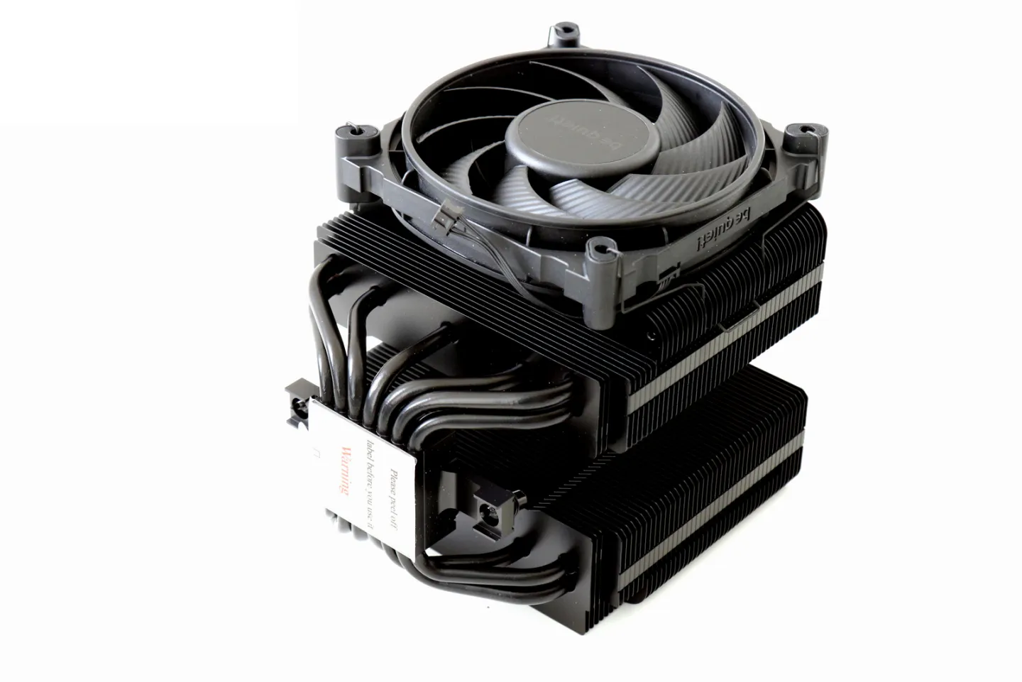

I've set up a new gaming PC and ive been wondering if my CPU 7800x3d and Be Quiet! Dark Rock Pro 5 having high temps as much as table 86 in games normal?
My case is - Lian Li Lancool III , 3 front fans all working no issues, 1 back fan all working no issue, pleny of space in the case, ive used a smaller previous version of the Lancool and had no issues with the flow and generally even this loads the whole case is pretty chilly so it dissipates the heat well.
I did have the shop where i ordered the parts from just assemble it as i didn't have the time to do it myself this time... and i fear they might have forgot the Thermal Paste, as the one with the CPU Cooler was not used. Is it normal that the 7800x3d run so hot in games? I know its a hot processor, but even max loads through benchmark people report 82-85C, while in-game most people say they get 77-80 at most... while im running at whopping 86 in games like Star Wars: Outlaws. I tried some PUBG too and it hit 92C and even shut down my PC once.
Idle temps are also pretty high at 55-60 at times, and often while running programs that download stuff etc it sits at 70-72C.
Coming from 5600X with a much cheaper CPU Cooler i never really hit more than 75 in both games i mentioned, is that differnce normal? Or i should really take the CPU out and repaste it and all?

I'm assuming you did check, if they have not left protective plastic film on cpu cooler?
Well.. i didn't want to believe it.. 2 shops ... 2 big shops my PC went through... and both did not remove the plastic.. after getting angry today after it got repasted... i went in and said.. xxxx it.. i'm opening it myself.. Guess what... the freaking plastic as left on...
From 86 degrees to 72C instant... im running a game on Ultra at 1080p 250FPS currently as im writing this, have 10 tabs open on chrome, the HWinf osensor, dsicord and 3 more apps... and im running 72.6C, im getting max 73.6... I don't know what to say.. honestly... I used to live in my capital city and there was this great shop that fixed my last PC... and got me great cooler etc and i miss them so much.. they are 10 times smaller shop but do 1000 times better job than this 2 big outfits i went to get my PC looked at... So much money..
I'm sorry to anyone who i annoyed with this thread.. and i'm sorry for my neglicence , let this be a lesson to anyone else...
