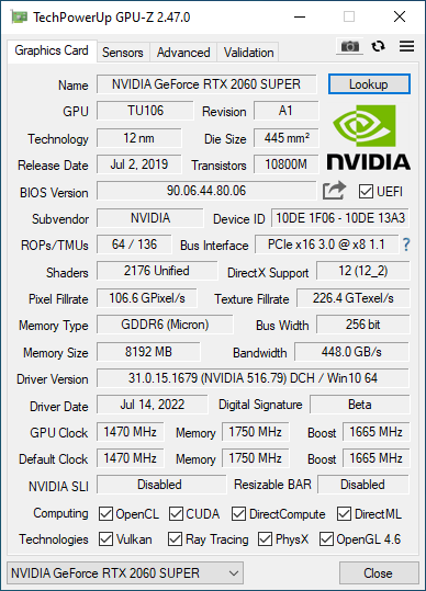

PC was performing normal until I found this in CPUZ (I tried many times to insert the image with no luck so I put down the link to it):
View: https://imgur.com/a/mWBqOH9
It clearly states that current PCIe link width is x8 instead of x16
I checked the bios and it states x16, and set everything related from -Auto- to x16
Rechecked CPUz and the result is the same x8
Is this issue MB bios related or is OS related? will reinstalling windows help? please advice.

Might give this a read, maybe remove the card reseat. Or make sure your NVME slots don't steal PCI-E lanes from the top slot.
I'm running out of ideas lol
If you are using the top slot is should be x16 click the question mark next to the x8 1.1 and run the render test and see if it changes.
Reactions: Fuad
The bios settings is correct. We have tried all the higher level stuff, Time to try just reseating the card and looking into if the NVME drives take from the pci-e x16 lanes (I don't think this is the case) I don't think software is the issue drivers etc.
