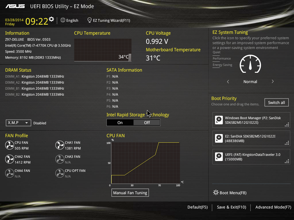

Is this the screen you are seeing?
EZ Tuning is basically just an auto overclock software. They use set values obtained from testing many CPUs, but the settings do not work for every CPU. It usually has three options: Normal, Power Saving and Performance. Normal runs the CPU at stock speeds, Power Saving most likely enables features like Intel SpeedStep and possibly underclocks the CPU to save power at the cost of performance, and Performance will disable any power saving features and overclock the CPU. It is possible that the Performance option is not available for you because of a locked CPU.

yes, I am seeing a screen like you showed. thanks for explanation.
