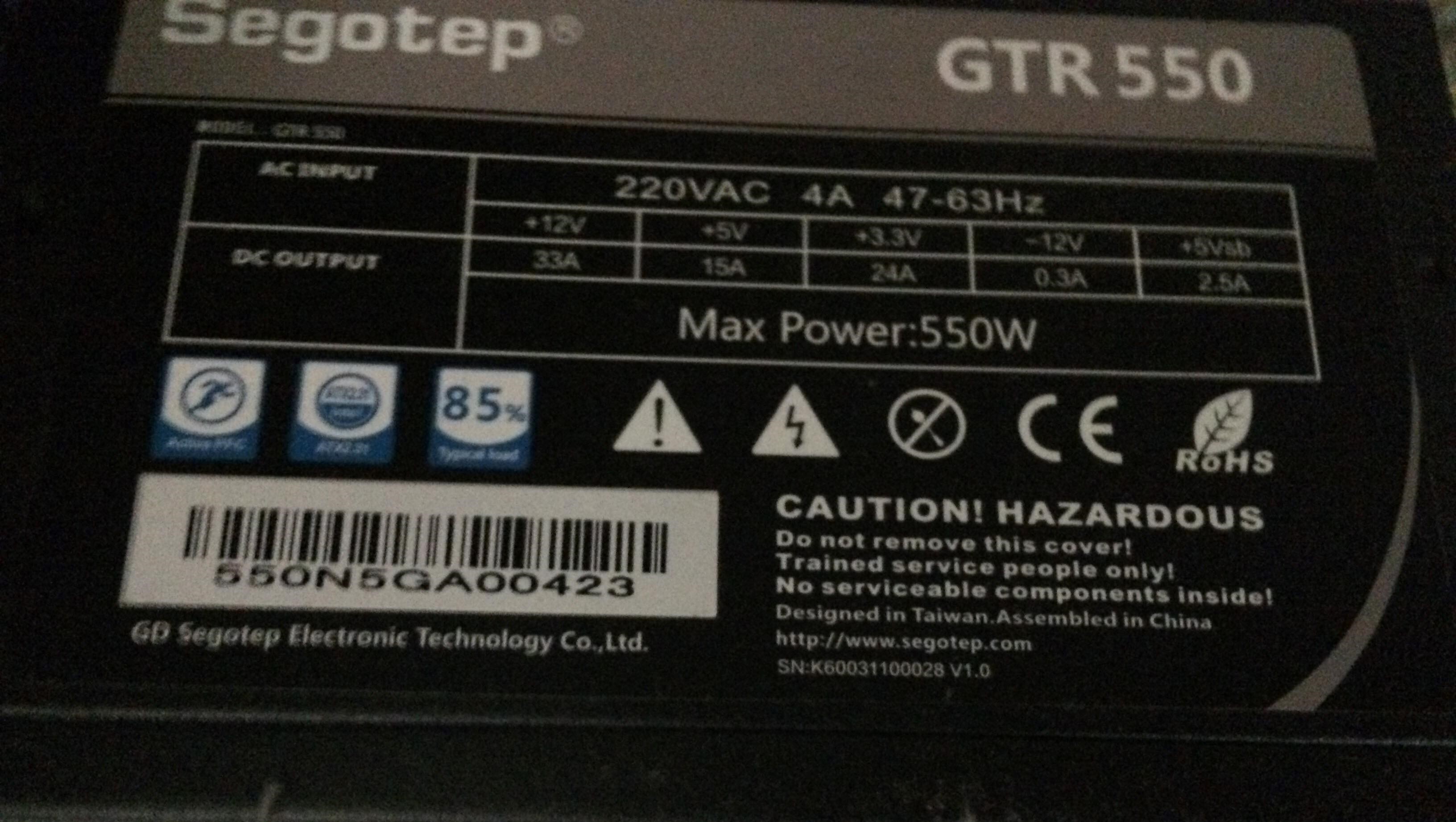

this is my psu which i haven't found in the pcpartpicker site.

The connector from the PSU should be a 6+2 labeled PCI-E, dont use the 8pin labeled EPS.
Looks like a crap PSU to be honest, I would get something decent from Seasonic/Superflower/Corsair/EVGA/XFX.

I don't even recognize the brand of the one in the picture.

I would suspect your psu.
I can think of no quality psu that does not have at least two 6+2 pcie connectors that is in the 550w class.
If yours has only one, I suspect it is a low quality unit that can not deliver its advertised power on 12v.
See if you can't test with a known good and high quality psu.

I am 99.9% sure it is the psu. You do not really need more wattage, you need more stability and clean power delivery. I am very partial to the Seasonic Focus line. I have always had good luck with them
I bought a corsair TX750M Gold, works now, thank you all
