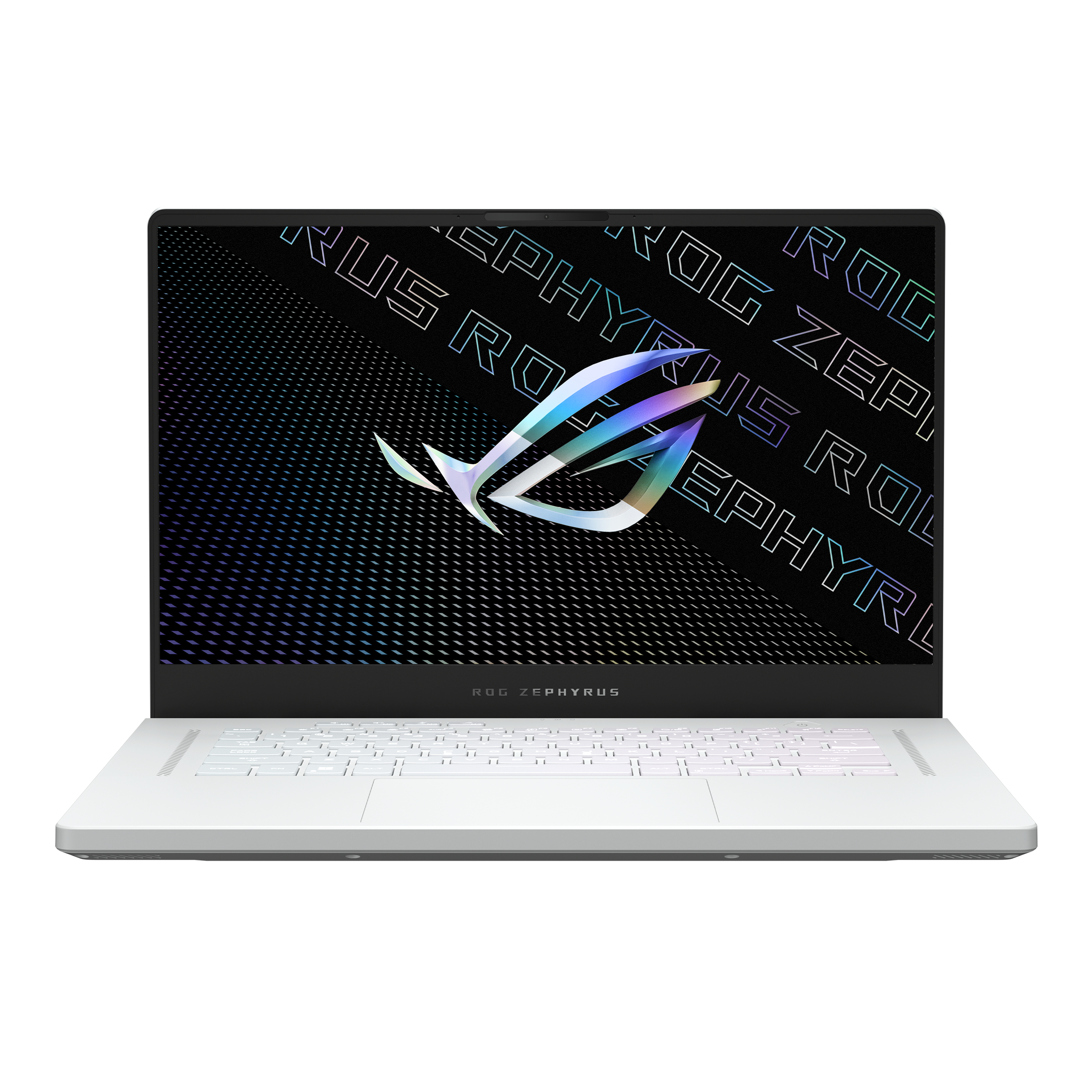

Yes I do have indeed 2022 edition but it is 7 6800HS with RTX3060 and it is Zephyrus. I tried to run Ryzen Master sadly though it kept giving me error with fonts in caps "this system is not supported" some text like this if memory serves right.
So I take it temperature target is not an option? I rather not to deal with thermal paste and internal parts as my thumbs are somewhat large can mess up lots of things in there, plus, it is liquid metal.
