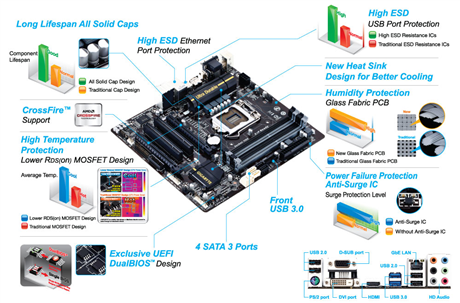

Gigabyte GA-B85M motherboard with on-board sound
