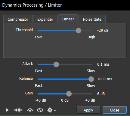

When ripping my DVDs to the computer, i use Wondershare. UniCoverter to rip them as the same source as the DVD itself.
As for the sound settings, When converting my video, I set the audio setting to auto.
Edit:
Ocenaudio is what i use to even the high and low sounds settings
https://i.postimg.cc/L61gCwds/gg.png
I looked at the Ocenaudio website, I'm not sure that I would use anything like that since it seems to be overly complex for the task. If you continue with that program it might be better to rely on the compressor function to reduce the variations in sound levels. You could possibly get better results in Ocenaudio by combining the Normalize effect with the compressor and noisegate.

Normalizing should always come first. First there's regular Normalizing to raise the maximum peak signal to zero dB. If you think the dynamic range between the volume being loud and then low is still to high you could also apply Loudness or RMS Normalizing where the average RMS level of the sound is increased and the dynamic range is decreased. Then if you're still bothered by the difference between loud and low, compression would be the next option.
