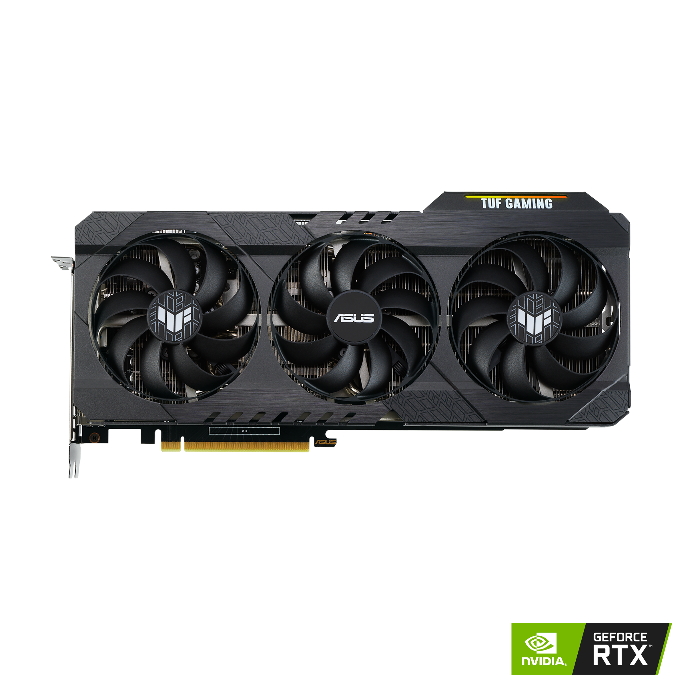

if you plan on doing any gaming at 1080P then I would look at this card.
ASUS TUF Gaming RTX 3060 OC Edition 12GB
Reactions: nate12

Tell me about the 4 monitors.
You will not be able to manage them with integrated graphics.
As a suggestion, look into a single large screen like the LG 48" 4k OLED units.
You can size and place many charts as you wish. There are 55" and larger if you want.
A single large monitor relieves desk mounting issues.
While that would work with the hdmi on most motherboards, I would still suggest a 3000 series card like theRTX3050 which will have hdmi 2.1 that can refresh the LG mentioned at 120hz.
