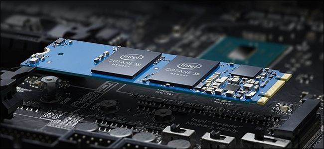

Well, do you have RAID or Optane ? Better list all of your components but it's possible that your CMOS/BIOS battery lost contact for a second and it got reset. See if BIOS has and option for "Factory defaults" or Performance Defaults" or something like that.

In short, RAID is way of connecting 2 or more disks to work together in some specific way.
If you don't use any of those, settings for them should be turned off in BIOS.
