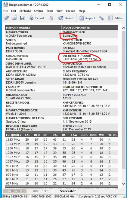

Hello, now in January I bought a new PC, but I have a problem, when raising the frequency or activating XMP, a few days later the BIOS is reset.
I did stress tests with AIDA and I had no problem. My memory is Samsung B-die.
I configured the timings manually and I also had the same problem. I used 1.35V and used the same timings as XMP 16-18-18-38.
The BIOS is updated to the latest version (2.90). I put the memories in slots A2-B2.
