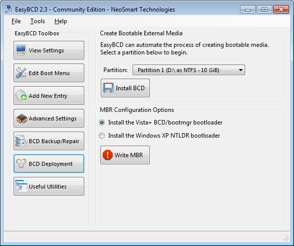

I've tried a number of things, even got a program EasyBCD 2.4 - but am not enough of an expert to dare to TRY it, not being sure it won't mess something ELSE up. Chkdsk/f C: did fix something (it didn't tell me what) and for awhile I thought it was fixed, but no....back to the same old same old.

Did you look at the help for EasyBCD?
seems they try to push another program of theirs to fix that error - https://neosmart.net/wiki/0xc0000098/

I have looked at their help, but this page (at least) seems to be aimed at Windows 7, 8, and XP - I have 10. I'm willing to fork over $20 for their other program, but meanwhile I think I've found a "Repair Disc" I made in April 2019 - that just might do the trick! We'll see, and I'll try to remember to let you know.

i only suggested program as you mentioned it. I would have suggested commands but i can bet program just uses same ones but with a pretty interface.
IN the past I have suggested this - https://www.lifewire.com/how-to-rebuild-the-bcd-in-windows-2624508
