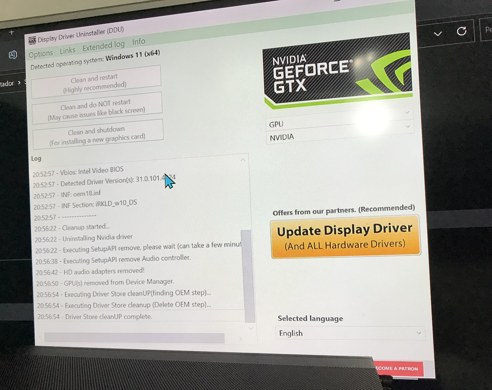

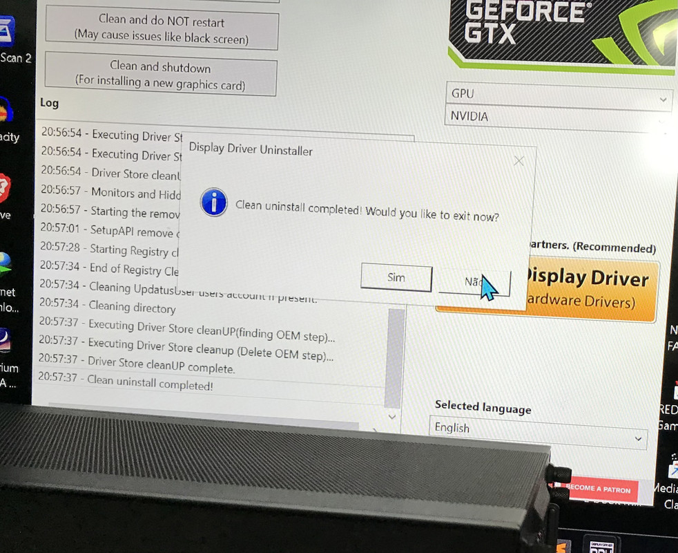

I was instructed in the NVIDIA forums to do the following (check the PASTEBIN message):
And this is what I replied to them.
No luck. Still no image after following all those steps, before Windows 11 starts.

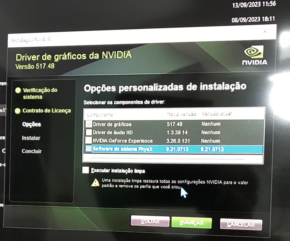

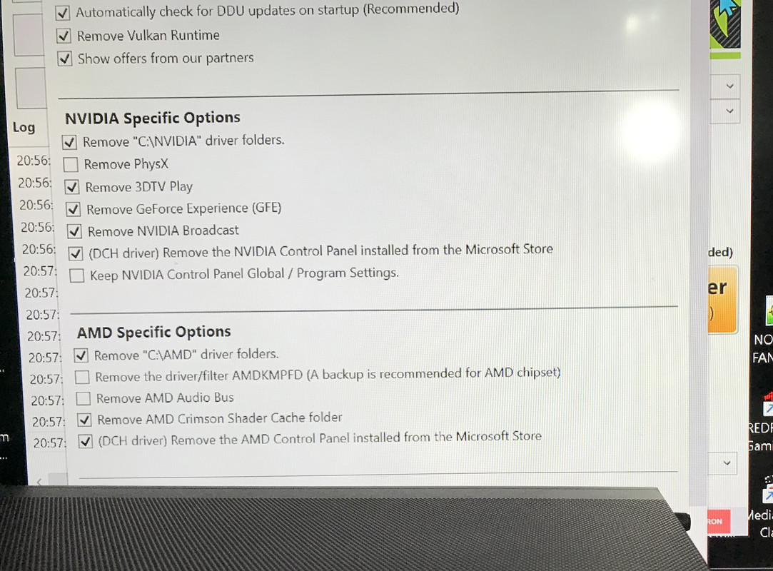

The only step I didn't understand correctly was this one:
Select NVIDIA SOFTWARE and DRIVERS (while running DDU)
As you can see from image 3333, there isn't such an option, and that's why in image 3334 it says PhysX is already installed, because it wasn't removed. I left the default options selected there, for the removal.

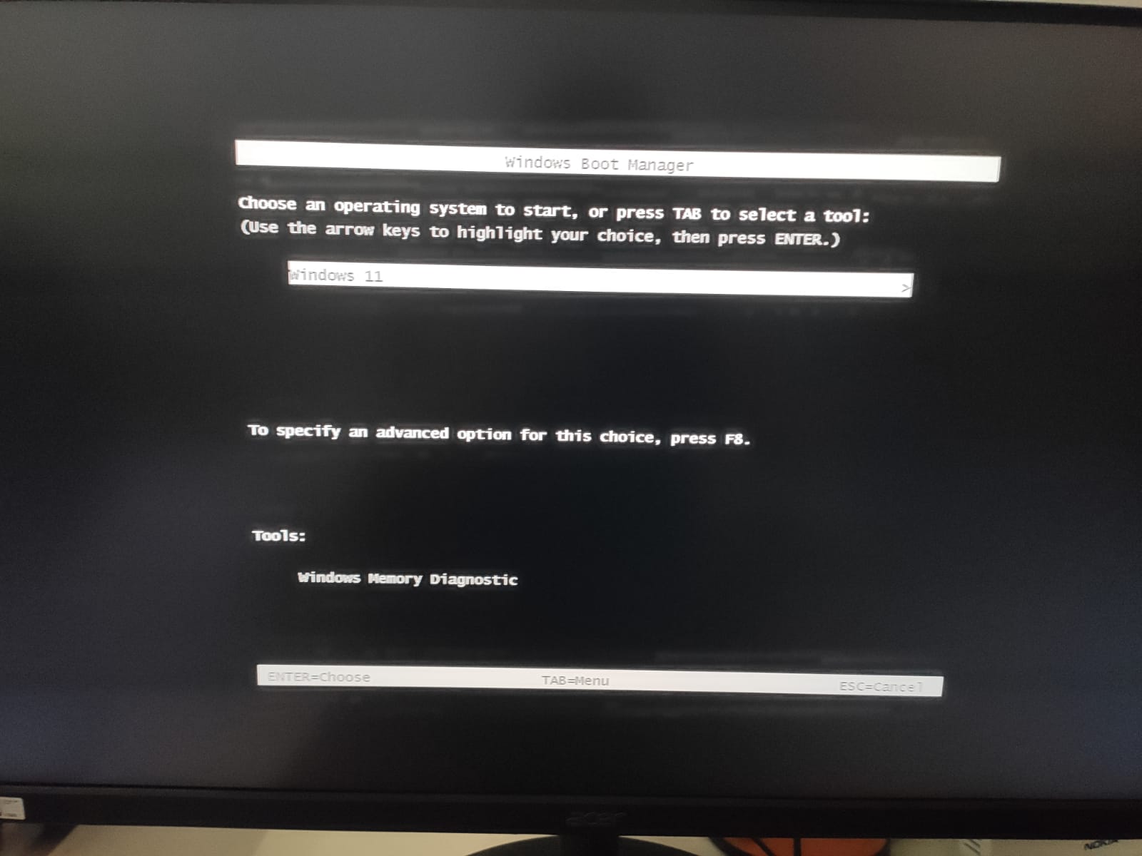

Wait, what just happened?
After I updated the GeForce drivers from the RTX 3060 yesterday, to 537.34, released 3 days ago:
Perhaps for the 1st time ever I could see something outside Windows... there was a DOS-like screen called WINDOWS BOOT MANAGER, showing Windows 11 (the only OS installed) and "Memory diagnostics" below...
It's set to 30 seconds in the sysdm.cpl (System properties)
But this time, I turned the monitor on FIRST (not later) and only seconds after, I powered the PC case... this could mean there's some sort of bad setting inside the OS which is (or wasn't) showing the MSI screen there... ?
Now, the 2nd test: what happens if I restart Windows 11, once I am there? Should display the same boot manager screen, right? Instead of going directly to Windows, and turning the monitor OFF.
The problem is: no, it repeats the same pattern/bug I discussed before. The monitor turns itself off after checking for HDMI #1, #2, and DisplayPort, then black screen (NO DISPLAY), and we can only see any image after returning to Windows, seconds later.
