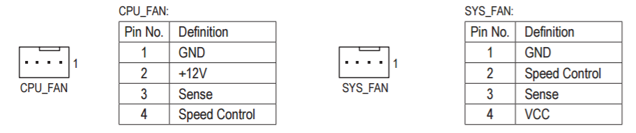

The problem is your Gigabyte B85M-DS3H-A motherboard's 4-pin SYS_FAN header -- it's not a true PWM (despite having 4 pins). Only your CPU_FAN is PWM (i.e., provides constant +12V at Pin #2 and provides Speed Control/PWM at Pin #4). On the other hand, the SYS_FAN header on your motherboard provides variable voltage/Speed Control at Pin #2.

The Akasa Flexa FP5S would require a true PWM header for it work as intended. Notice that in the splitter, the 4-pin connection to the motherboard only has 2 wires (Pin #3 and Pin #4) on it. Those 2 pins are the Sense (or tachometer reading) and the PWM/Speed Control, respectively. What the splitter does is use the constant +12V power from your PSU (via SATA) and use the PWM signal coming from Pin #4 of the motherboard's header to vary the speed of 4-pin PWM fans. The Pin #3 just gives the reading of how fast the fan (that is connected to one of the five splitter that has a Sense wire) is spinning.
Unfortunately, since your SYS_FAN header cannot provide PWM signal/Speed Control on Pin #4, the result is, only constant +12V is supplied to your Noctua 4-pin fan (via the SATA power). Thus, such constant voltage will make your fans run at full speed 24/7 (akin to plugging it on the PSU directly).
