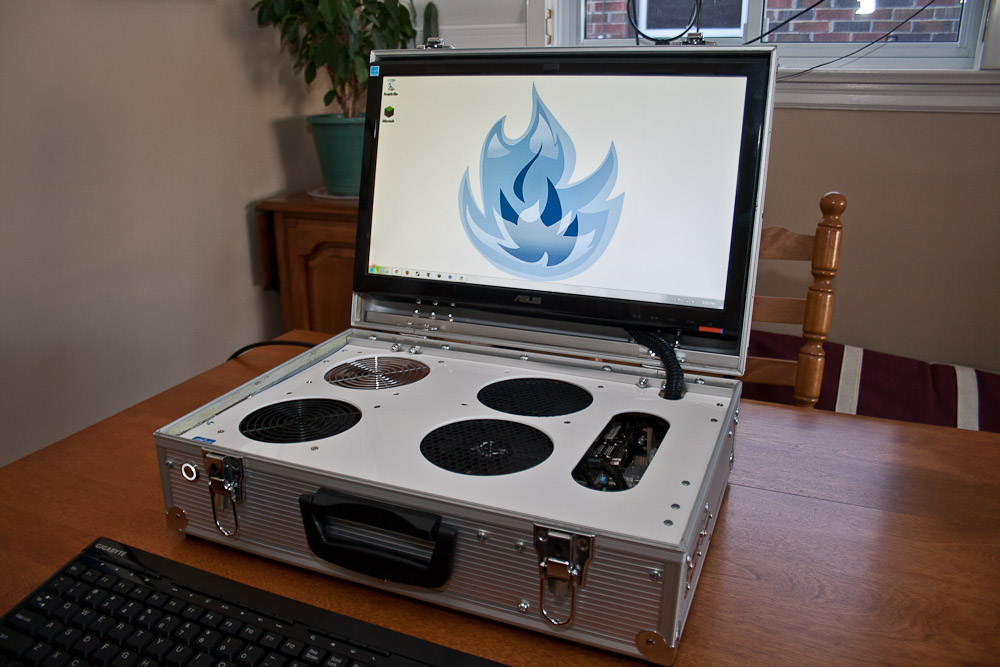

if you want to stuff an lcd panel into the lid then you would want one with a thicker lid such as this below. keep in mind that you might have to remove the lcd from its bezel unless you get something like a usb portable lcd panel which already is shaped like a tablet and is easy to stuff inside
due to the rather limited height of briefcases you may want to include small half inch to inch legs so that when you lay the case down you can have room underneath. this would allow you to put larger fans in such as a 120mm.
if you plan to always have it open then doing something...
if you plan to always have it open then doing something like the below image is also good.
