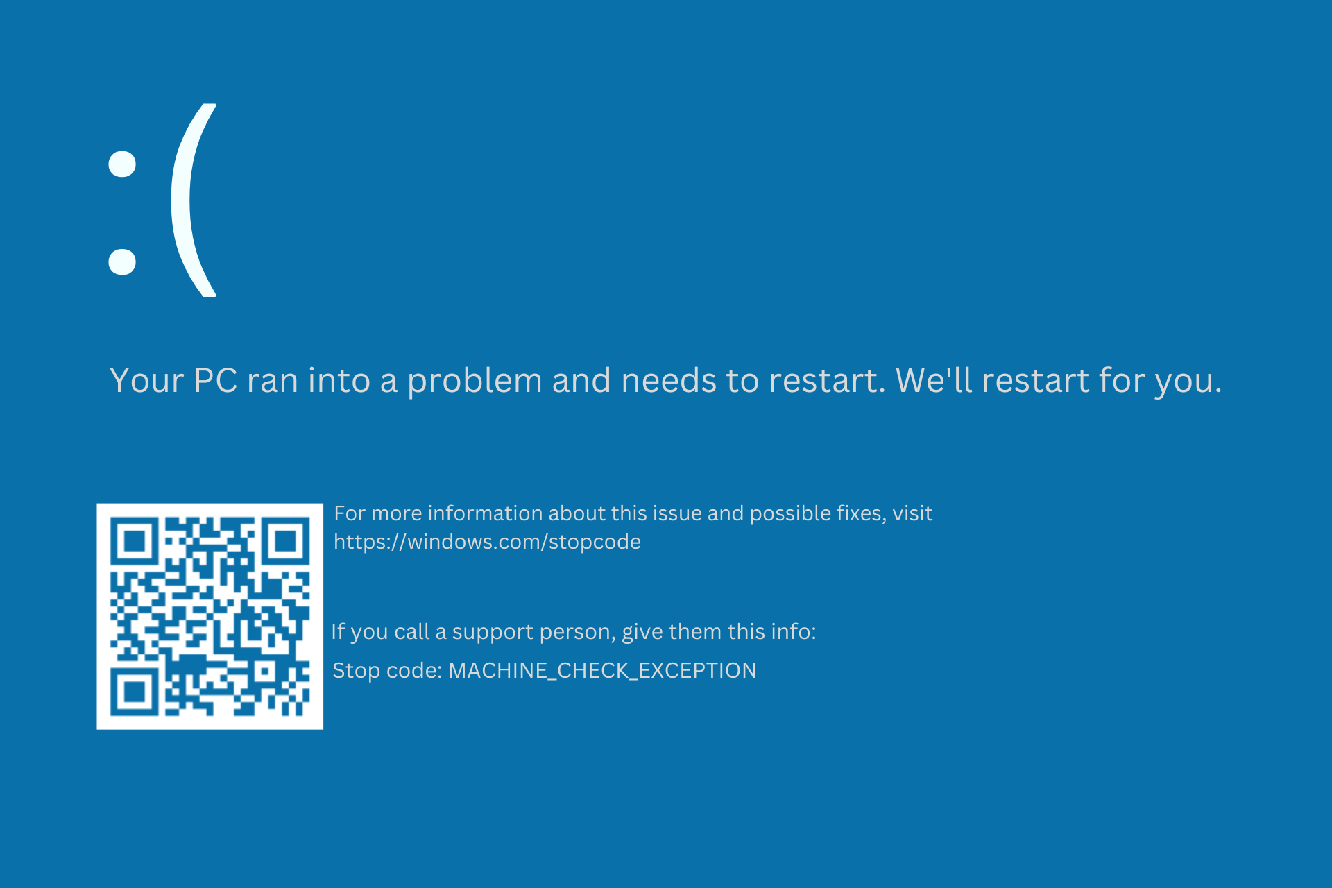

I built a new pc about a month ago now and it has crashed about 8 or 9 times all with the error code MACHINE_CHECK_EXCEPTION. These crashes occur randomly (idle, in game, browsing the web) and I can not seem to figure out exactly is going on in my case, despite looking at countless threads online.
More info about the crash:
Bug check code: 0x0000009c
Parameter 1: 0000000000000000 Parameter 2: ffff9a81a554ccd0
Parameter 3: 0000000000000000 Parameter 4: 0000000000000000
Caused by driver: hal.dll
Caused by address: hal.dll+491e1
Crash address: ntoskrnl.exe+1bfcc0
Event ID: 1001

Machine checks are a hardware problem, not a software problem.
https://en.wikipedia.org/wiki/Machine-check_exception#Possible_causes
Which hardware do you think it would be? I've already ran memtest with no errors. Would it be a bad CPU? Ive also hear it could be a bad motherboard that not very likely.

Machine Checks are called by the CPU, but aren't ALWAYS hardware. They can often be firmware conflicts with hardware, temperatures, and in the rare case, drivers. So they CAN be a software problem, just rarer. But hardware problem doesn't immediately mean hardware is faulty, but can mean the hardware is conflicting or throttling.
With the dump file we may be able to advise more, but jumping onto random hardware won't help.
  • The most common cause of Machine Checks and WHEA errors are excess temperatures, have you monitored GPU and CPU temps under load?
  • Do you have latest BIOS installed?
  • Do you have latest drivers isntalled direct from the manufacturers website?
  • Are you running any overclock or XMP anywhere at all?

I have run the dump files and you can view the full reports here:
Dump 1: https://pste.eu/p/131C.html
Dump 2: https://pste.eu/p/e4z5.html
Dump 3: https://pste.eu/p/WKFM.html
Dump 4: https://pste.eu/p/i1jw.html
Summary of findings:
BugCheck 9C
Probably caused by : intelppm.sys ( intelppm!MWaitIdle+1f )
Bugcheck Description:
"This bug check indicates that a fatal machine check exception has occurred. In Windows Vista and later operating systems, this bug check occurs only in the following circumstances:
  • WHEA is not fully initialized.
  • All processors that rendezvous have no errors in their registers.
For other circumstances, this bug check has been replaced with bug Check 0x124: WHEA_UNCORRECTABLE_ERROR in Windows Vista and later operating systems.
For more information about Machine Check Architecture (MCA), see the Intel or AMD Web sites."
About your bugcheck:
"A machine check exception is almost solely hardware based. It is possible in rare circumstances for this to be a driver, however it is very unlikely. It is often caused by:
  • Component overheating
  • Unstable overclocking or XMP profile
  • Faulty hardware"
Some things to consider:
I would highly advise you to view the full report above, as this will contain much more detail as to the bugcheck and modules running at the time.
  • It may be worth disabling your XMP to see if the issue persists.
  • Does the issue occur every day? If so, run with a clean boot and see if the issue persists. This will disable all third party drivers so you won't be able to do much.
  • If you have latest BIOS installed, you may want to see if there is an update for your Intel Management Engine as this and your BIOS should be aligned
  • Antivirus can cause all manner of problems too, are you on a paid or free version? It may be worth uninstalling and running on defender temporarily to see if issue persists.
  • All of your stop errors care calling the CPU - which doesn't mean the CPU is to fault necessarily, but that the CPU is calling the error at least.
Whilst I understand it is highly likely this is hardware, we tend to prefer eliminating all software first to prevent you from buying hardware before we'd properly confirmed it. You have a LOT of drivers running so it could be any theoretically.
