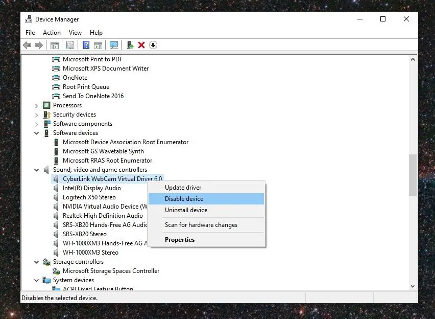

Whilst I'm going through the Farbar logs, can you upload SS ( screenhots ) of these please.
Device Manager ( no need to expand )

Here is a SS of Device Manager: https://1drv.ms/u/s!AuQfX8syP_a0ghhhXj4yMULcvnS2
and Disk Management: https://1drv.ms/u/s!AuQfX8syP_a0ghcXokvFCi4Z9uo5
I have now disabled Fast Startup
