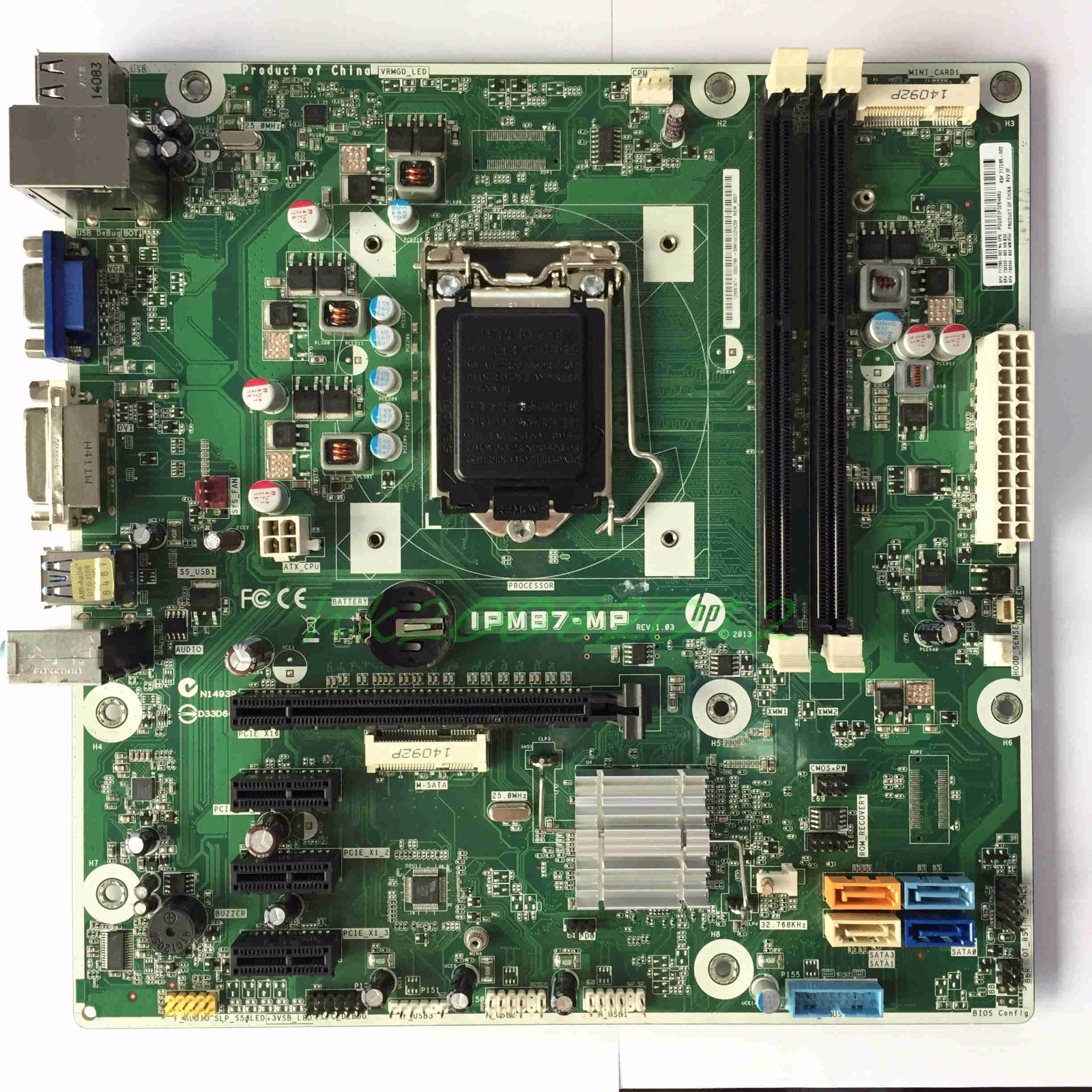

Now for installing, lets first find the PCI-e x16 expansion slot on your motherboard. Open the link and find the picture of the motherboard. In the center of the picture you will find, "IPM87-MP". Just below that is a long, black socket, that is your PCI-e x16 expansion slot.
https://ssli.ebayimg.com/images/g/g4oAAOSwOudZ3BEV/s-l1600.jpg
