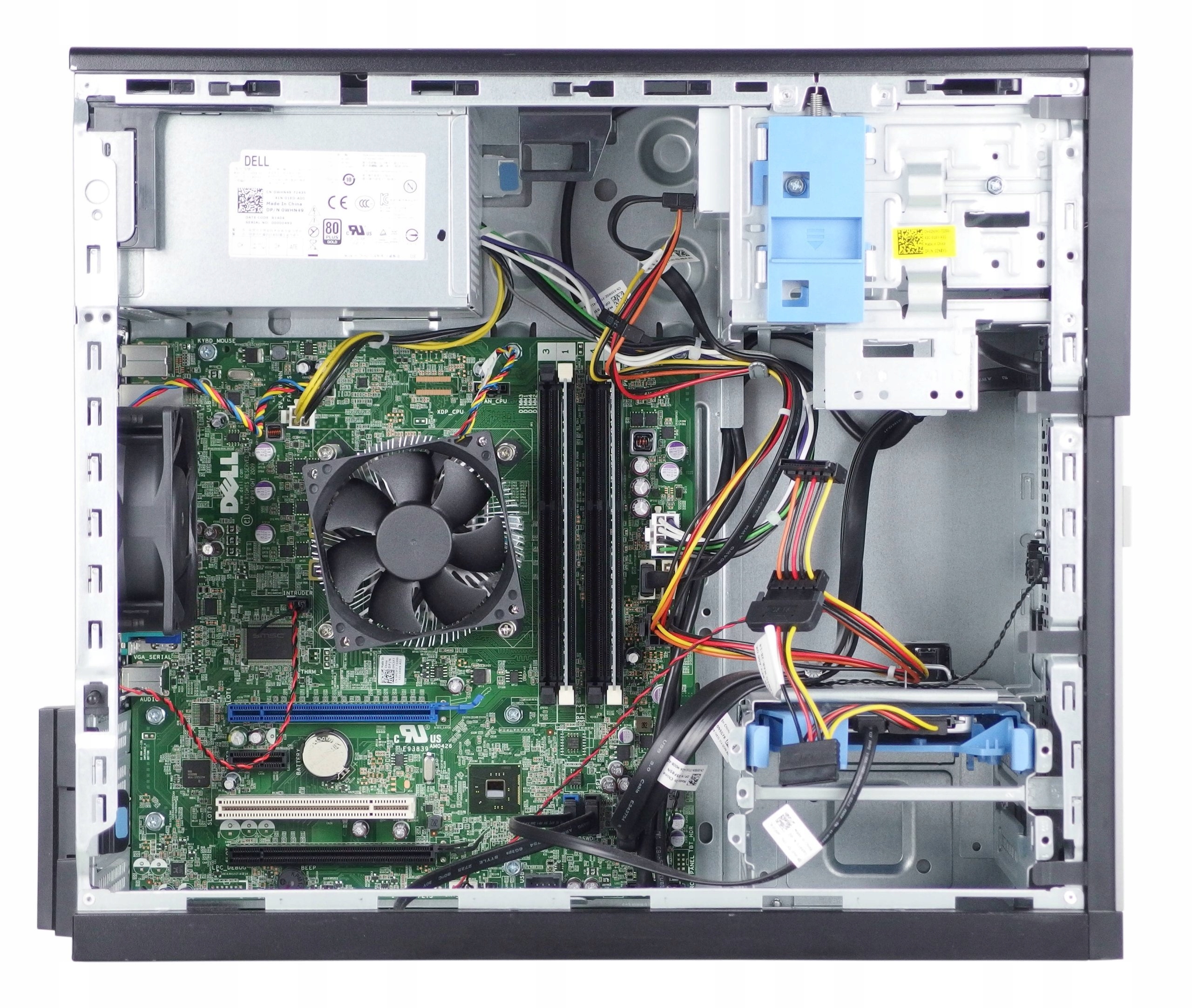

This model comes with different versions of case.
To check this out, You need to unmount the cover of the case and measure the sizes.
Another thing - what specs are inside? PSU/Mobo/Ram/CPU? This case doesn't seem like best one for cooling tbh....

About the size - try to post a picture of Your rig. The best would be with unmounted cover / side wall (put link to the picture here)
Is this the right case? https://b.allegroimg.com/original/0c7e49/158ee52b4fe681832262f72f6a7b
