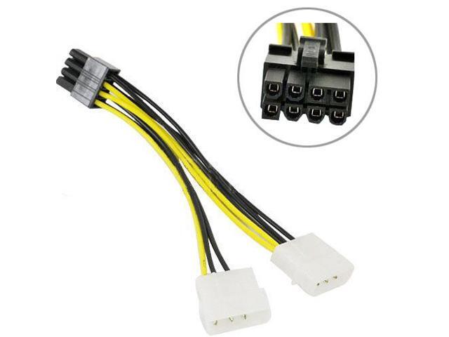

Do you mean this molex to pcie adaptor? You don't have pcie cables coming directly from your psu? What psu do you have?
You don't need to use the cables that are included in the box if you are trying to connect 2 of your 6 pins to the cable that will then equal one 8 pin. If you are doing that and you mean it has 2 left over pins hanging to the side of each one, then you already have a 6+2 which is the same as am 8 pin pcie and just combine it and plug that directly into your graphics card.
