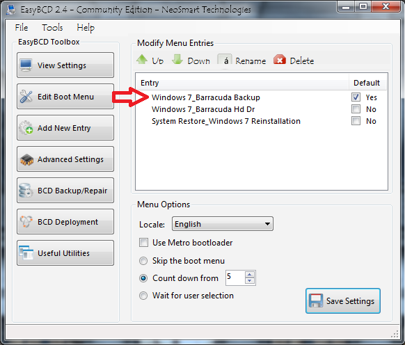

1. Change the boot record that I created with EasyBCD. If you're not familiar with this, you can edit the order of the hard drives and make either one boot first. Thing I was wondering though is if I leave the D drive in it's current connection at the motherboard it's in port 1 and not port 0 like you would normally have your C drive. I do not know if there is some reason not to do it this way with the main hard drive being in port 1 instead of 0.
I just tried this and it works. I can edit the names also to change the name of the Backup drive above to the name of the drive below it and vice versa. But like I said, don't know is there something wrong with the main drive that normally boots not being in port 0 of the motherboard.

By doing the first method outlined above (using EasyBCD to alter the boot record), Disk Manager now shows the Backup drive on position 1 at the motherboard as the boot drive:
Disk 0 was my main drive that I want to now only take some folders and files from and place them on the other drive. Then, I will rename the hard drives and Disk 0 becomes the Backup that I will use to periodically clone. Once I make a clone of the Backup drive, and do one more edit to the boot record made with EasyBCD, this will be a dual boot system again, but with my main drive on position 1 at the motherboard instead of 0.
If anyone knows you should not have the main drive at position 1 for some reason please reply. But for now looks like this is a glitch-free way to do it.
