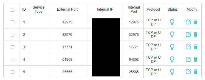

Hello,

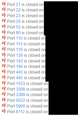

Im trying to open ports on my router, TP-Link Archer VR400. The issue is that my public IP address indicating ALL ports closed, which is something I never experienced. Everything working fine, except Hamachi and stuff around hosting public Minecraft server.
I tried open several ports, I tried disable router firewall and my firewall in Windows, I tried to stop my antivirus software - Nothing works, still all ports closed. I did this with my previous router and everything was simple, this time I cannot perform the same way I did this last time. Ill be grateful for any tips!

You can't just scan random ports and expect them to work even if you have them port forwarded. You must have a actual application running on that port that will respond.
In any case the easist first test is to use the DMZ option since all you have to get right on that is the internal IP. Many times port forwarding rules on routers are confusing.
If this still doesn't work have you verified that the public IP you see on your router wan port is the same as the one sites like whatsmyip and port scanner sites see. If these are not the same you do not actually have a public IP and portwarding can not be done.

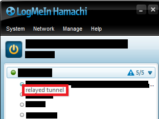

Hmm... when I did that last time, I had most of them open... DMZ not helped me, but that's probably misunderstanding, what I needed to do. Hamachi saying "relayed tunnel" and I had a clue that ports are not open, which must be the same scenario with Minecraft server. I tried to watch most common issues but i must have very different issue. Any other blind shot? I know Im very general but Im just trying to catch any other clues.

Okay, let's say that my IP is behind NAT. But that's still does not explain, why Hamachi is not working properly, when it was working without problems month ago. I can additionally pay public IP monthly but I'm quite afraid that the issue is somewhere else. Reinstalling Hamachi didnt solved anything. I cant really portforward without public IP? Even when I have this option on router (NAT Forwarding) ? UPnP detects the hamachi and it's port so it doesnt looks like blocked or something...
