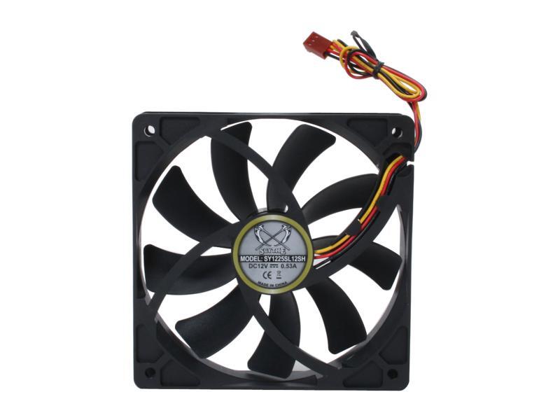

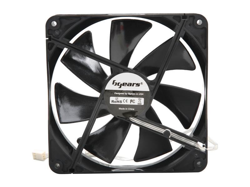

I want to buy new case fans for my PC. My current ones use 4-pin Molex connectors and that is it.
The fans I want to buy have either 3 pin or 4 pin connectors. I want to adapt those to a 4-pin Molex connector, which will lead to the PSU.
Someone please tell me the difference between the following pictures.
https://www.newegg.com/Product/Product.aspx?Item=N82E16812423171&cm_re=3_pin_fan_connector_to_4_pin_molex-_-12-423-171-_-Product
https://www.newegg.com/Product/Product.aspx?Item=9SIACJF5497317&cm_re=3_pin_fan_connector_to_4_pin_molex-_-9SIACJF5497317-_-Product
Which is it?! The fans I want have a female 3 or 4 pin connection, but when I read the product description, it sounds right but does not look right.
What do I use to make a case fan go from a 3 or 4 pin to a 4-pin Molex to connect to the PSU?
Thank you in advance.

Both linked fan images have 3-pin female fan connector and you can plug them in into both adapters you linked above.
The difference between the adapters is as i described; first one has room for 4 fans while 2nd one has room for 1 fan.
As far as the 1st adapter goes, you can plug 3-pin female fan connector to the 2-pin male connector and fan works as it should be. Only thing is that the 3rd wire fan has (for RPM signal) will be unused.
