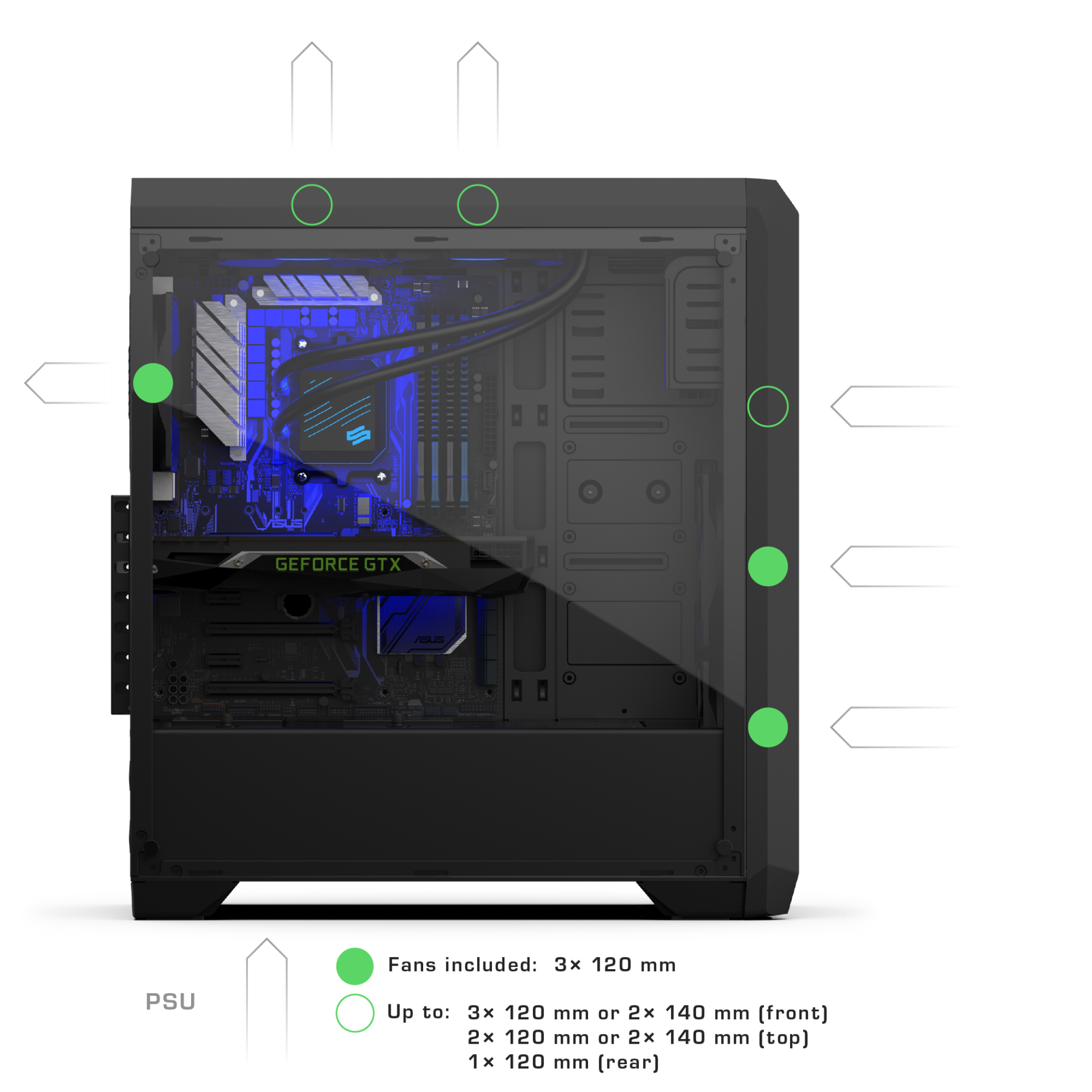

Hey,
I have SPC Regnum 4TF case, with 3 stock fans installed. This thing can hold:
Rear: one 120mm fan
Front: three 120mm fans / two 140mm
Top: two 120/140mm fans
(Of course you can find full specs online c:)
I would like to make cooling in this computer much more efficient by replacing & buying additional fans (my gpu temps are going insane during these hot days, even on undervolt...)
Should top fans be blowing air inside or outside the case?
What fans should i buy? Can you propose exact models and configuration?
Thanks!

Methinks part of this has to do with the 2060 Windforce's directional finstack.
They function as air guides. These are aimed to exit out the front and back, unlike many other open air models which are aimed at the sides.
The back exhaust shouldn't be a problem, but the front fan is likely creating turbulence with the front exhaust; working against it and increasing gpu core temperatures.
Maybe skipping the front-middle fan as shown in the diagram above will help.

So, you propose to move middle-front fan to top-front position, and not putting anything here? This way, I will have to put 120mm fans here (probably) instead of 140mm (I dont know what is their placement at the moment, I will look into case when I return home). Any good 120mm models?
Yes.
Didn't the case come with three 120mm fans? Well, at least it says so in the product description... what's wrong with those? They should do fine, since the case is meshed out.
Put 2 of them in the front - skip the middle space, of course - and install the 3rd one behind the cpu cooler. Then see if that helped gpu thermals.
