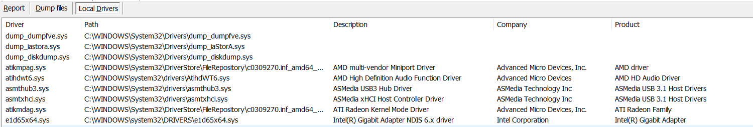

I went to the official Asus Z170 website to update all the drivers, now i have all this. Is it right?
https://1drv.ms/u/s!ArltMoWhaQYBhBY6NMLNsGGiH5uT
I guess all these Falses mean that the last ones are not working anymore.

no, you want to focus on the dates of the drivers.
the drivers may start up during the boot process then find that no hardware exists for that driver and it then stops. This would be normal operation.
you would look at the dates of the drivers like amdsbs.sys dated 11/12/2012
then go here to see what the driver is for:
http://www.carrona.org/drivers/driver.php?id=amdsbs.sys
in this case it is a older AMD AHCI Compatible Controller driver
but it is much older than your other AMD drivers dated in 2016. I could be a mis matched driver, malware trying to hide as a AMD driver.
sometimes windows update will install a old driver when the OEM does not provide updates.
note: my system has the same amd driver installed with the same date so I don't think it is a problem.
