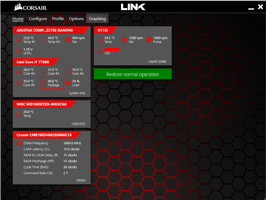

I just build my first new PC and I'm currently using a Intel i7 7700K with the Corsair H115i Extreme Cooler and under only 10% to 20% load the CPU is averaging at about 50 degrees celcius, this seems to be unusually high and the air coming from the radiator feels cool. I'm concerned that I may have not installed the Pump Correctly and the energy is not being conducted from the CPU to the Pump sink surface, even when the Fans are turned to maximum there is no effect on the tempreture.
I took a screenshot of Corsair Link http://i61.photobucket.com/albums/h61/Peridot-2F5L-5XG/Capture_zpsbbgbtjzo.png
I was hoping some more experienced builders could look over this and recommend what I should do.

Sounds as if the pump isn't correctly seated or you have simply forgotten to connect one of the cables, first run through the installation manual and check you have connected the cables correctly, if they are then remove the pump and reseat it. Be aware, you MUST replace the thermal paste, reusing the pre applied paste is almost certainly going to leave voids in the coverage, the last thing you'll want to do with a i7 7700K!

I refitted the Cooler and spent a few hours cleaning the thermal paste completely off it, when I removed the cooler a tiny bit of the paste had spilled over the edges and I cleaned that up and added less this time. I also made sure the secure the pump more tightly and now the ambient temperature seems to average around 30 degrees Celsius but still fluctuates very rapidly and peaks randomly to 59 degrees and this is under very low load.
I'm not certain what load would count as idle but under only a 4 to 14% load the temperature ranges from 44 to 29 degrees Celsius, I don't know why the temperature fluctuates so rapidly.

Under a constant load of 14% temperature increases to over 50 degrees and the cooler temperature is only 27,2 degrees, so obviously something is very wrong but I have no idea what more I can do apart from cleaning it a third time and refitting the cooler again but I don't think that will work, I followed the instructions on the H115i manual directly and fitted the cooler again and all the cables are fit into their correct locations but whatever the problem is it is clearly beyond my level of skill and I don't know what more to do.

44 to 29 degrees Celsius, seems about normal for these chips, a couple of background processes will raise temps.
To test thermal solution you really need to put chip under stress. Prime 95 ver. 26.6 small fft. Keep an eye on temps and discontinue testing if temps exceed mid to high 80's.
