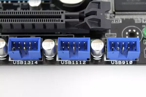

I'm having trouble picturing the system, though. Are the two ports "available" because the board comes with a cable with a connector on one end that splits into two USB female ends? So if I get a case with two USB3 header ports it would come with two short cables that would go into this double-headed end?
AFAIK, no boards come with cables like that (although now that I say that, there's probably one that does.)
A board has a header, looks like this for 3.0:
and 2.0:
And newer/high end boards have Type-C:

Cases, or hubs etc have the cables from the front panel.
