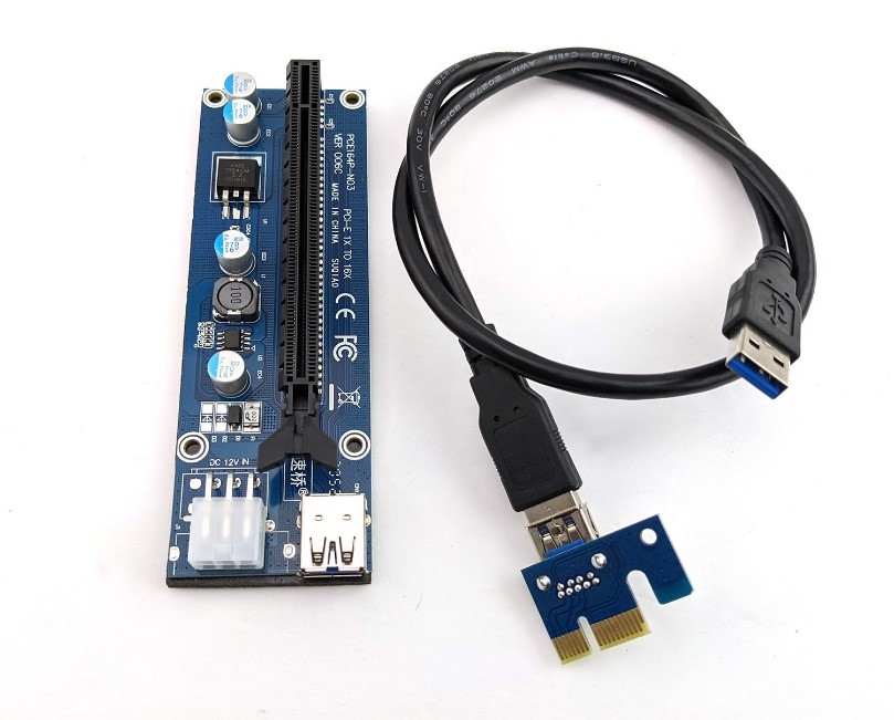

my motherboard has 2 PCI Express slots, x16 and x1, if i would buy Kolink Riser PCIe x1 - x16, and connect rx 5700 xt to riser and riser to that x1 on my motherboard and my gt 1030 to my motherboard, would it work then? i cant plug rx 5700 xt into motherboard cuz it covers that x1 on motherboard
It should work as long as you get a proper riser (something that looks like this)
However, a piece of warning here: it is possible (although rare) that your VBIOS flash attempt failed in such bad way that you would not be able to make system POST with 5700 installed at all. If that happens your only option is repair shop as they have ways to flash VBIOS without putting GPU into PC.
this, https://www.conrad.com/p/kolink-riser-cable-pcie-x1-x16-riser-cable-1604932

pc wont boot to windows with connected rx 5700 xt(power cables and pci-e), and gt 1030. pc will boot to windows with gt 1030, and rx 5700 xt connected with only power cables, 8pin and 6pin, but not to pci-e. if i start pc with power cables connected to rx 5700 xt, but not to pci-e, and at windows connect to pci-e, will something bad happen? will it work like shortening bios chip?

If shopping at allegro.pl, it's pretty certain Op is not in the US, but much closer to Poland.
Op, right now that card bios is bunk. It needs professional help to hard flash the bios. That cannot be done by the average user as they do not own the equipment to do so. Trying to shortcut by hot-swapping does not work.
To do so generally requires either removing the bios chip from the board, where it can be directly plugged into other equipment that can force a bios hardcode, not through the pcie slot.
